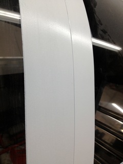

finger nail...
[img]cid:6B4E747F-50A9-4A2C-B2EF-5EA23DDFBF4E[/img]

Just walked down and measured mine - about 0.050.
For the last step in this I put a thin layer of mico over the entire door
and cabin top gap (door shut and locked). After it set up a little I took a
razor and cut along the gap. It needs to set up enough so it is like
cutting clay. After the mico cures then do a final sand. This provided a
means to have a very uniform and level fit.
This is also a good process to have a perfect oil door fit.
After all that - you then get to chase pin holes for a few weeks.

wow, that is great, mine is not near that...

You guys have some amazing fiberglass skills.  I think mine is +- .25"!

Lot's of great information and quality work here! I think I'll shoot for .040" or so and see where it ends up.

I think mine is about .050-.060". Paint will close the gap some and you'll want some expansion room.
