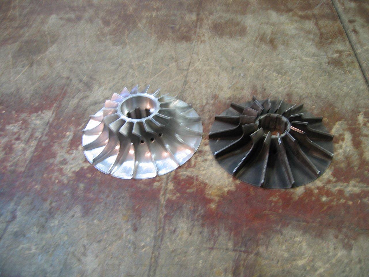

Attached the picture that I got from you some time ago.
If I remember well, the impeller goes faster on the M14R.
Jan
On 29/06/15 18:57, "Richard Goode" <owner-yak-list-server(at)matronics.com on
behalf of richard.goode(at)russianaeros.com> wrote:
<richard.goode(at)russianaeros.com>
We funded OKBM (Vedenyeev) for the development of the M 14 R. It genuinely
does give the power, but is rather too specialised an engine for general
use
as Jan implies. As he correctly says, Lyulka were responsible for the
supercharger, which is where the extra power is developed.
If you look at the impeller and diffuser of a standard engine, you will
see
that, in supercharger terms, they are very crude with the vanes only
having
single-plane curvature and clearly much less efficient than they could be.
So Vedenyeev went to Lyulka, who make the exceedingly fine and powerful
jet
engines for the Sukhoi 27 family of fighters, and they produced a new
impeller and diffuser with compound curvature.
Also the impeller is turned a little faster - unfortunately I can't find
the
figure at the moment - than the M 14 PF, which again helps.

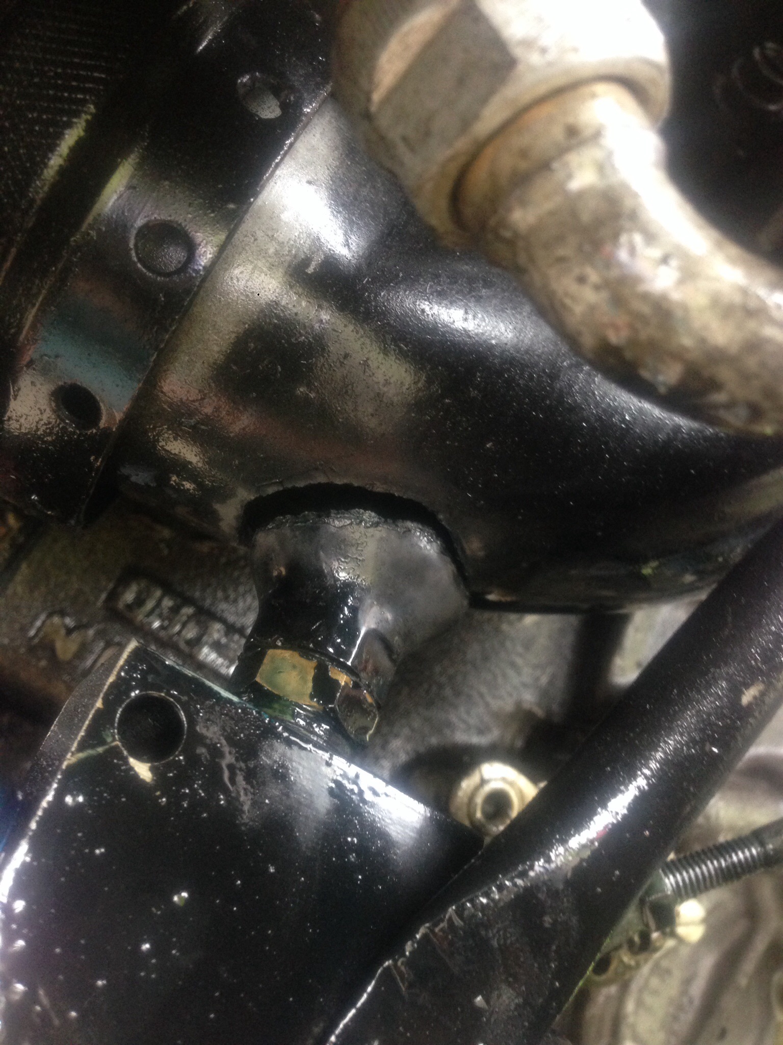

PostPosted: Tue Jul 14, 2015 4:46 am    Post subject: Re: Engine roughness, as in stops. starts. stops. starts. Reply with quote
Hats off to someone who posted it waaaay back in this now crazily fractured thread (mods? This is the only forum I've seen that does this)
It was an intake leak. Big one
