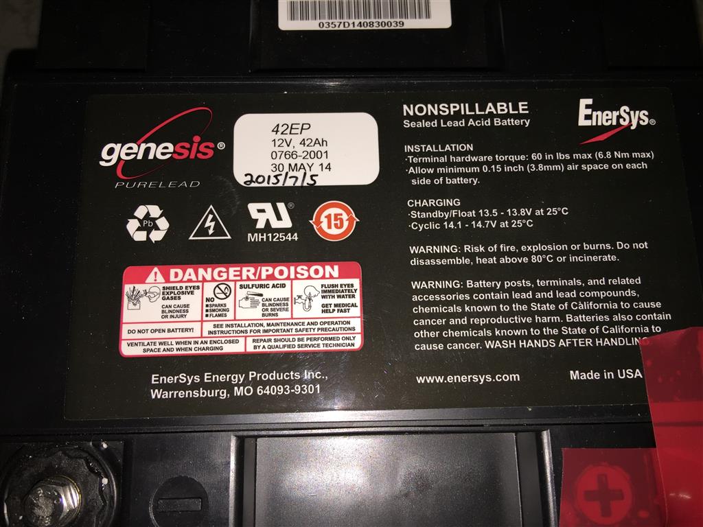

jorgen.nielsen(at)mweb.co
PostPosted: Tue Jul 14, 2015 7:45 am    Post subject: L29-List Digest: 1 Msgs - 07/09/15 Reply with quote
Been running a set in series that lasted a good 8 years. See the pic for latest. Batteries from Enersys, genesis 42EP. Works great, I have noticed the float voltage a bit higher than any other battery I have tested.
Another tip that may help someone: at some point I could not get hold of a 24V smart charger, the type you can leave connected. I then found an ad in a bike magazine for electric scooters (and parts) that run off 24V, called them, ended up buying a great little 24V charger that may be left connected. Does not put out a lot of amps, but great for keeping battery topped off. Was cheap enough.
