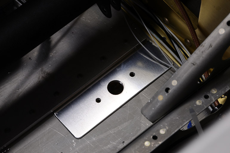

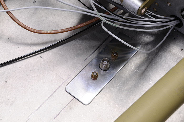

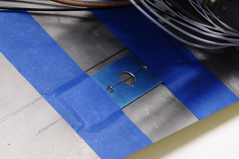

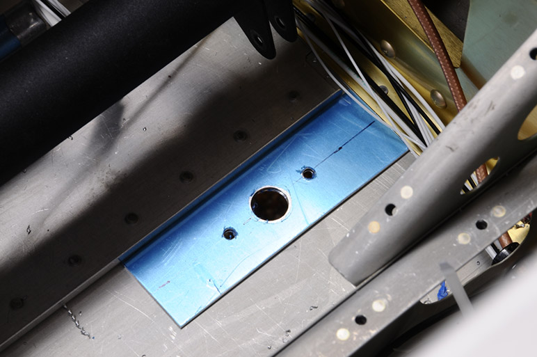

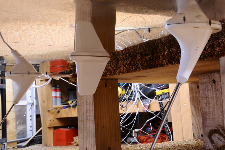

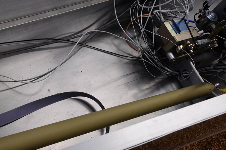

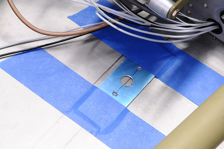

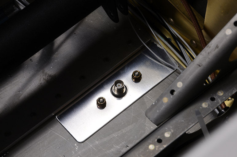

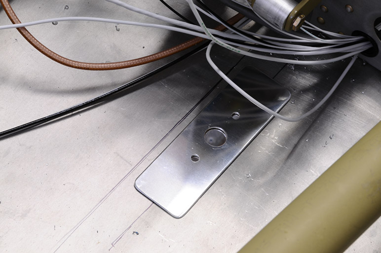

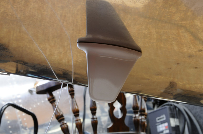

Hi Stan,
I've got the NavWorx certified ADSB in my RV-8. I mounted the Garmin GTX-327 transponder antenna right in the middle right behind the main spar. I mounted the NavWorx ADSB antenna right behind the elevator bellcrank. Everything seems to be working fine. Attached are some pictures.
