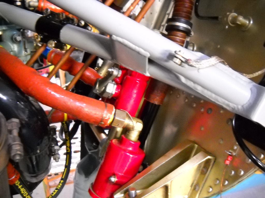

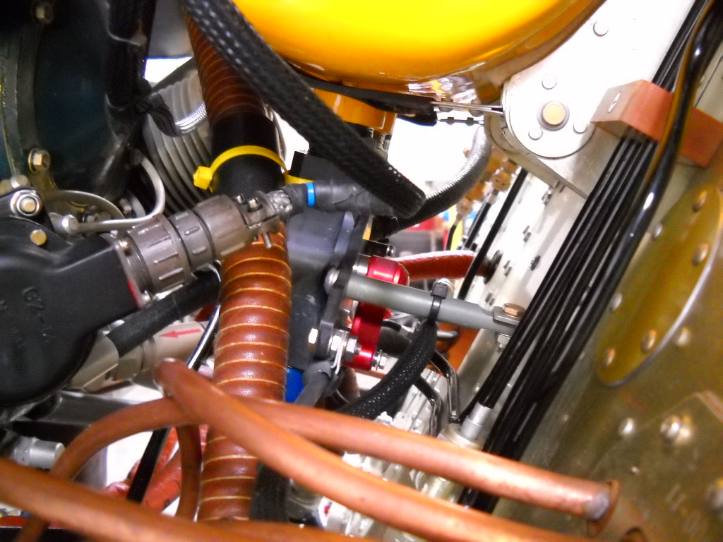

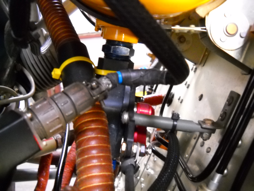

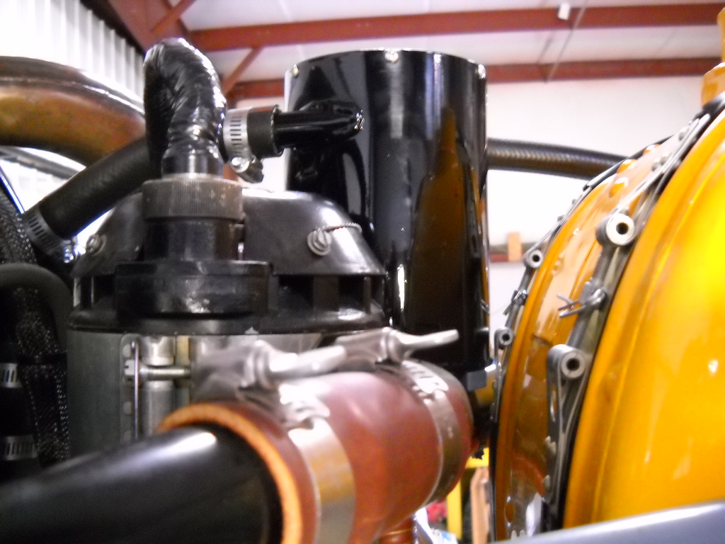

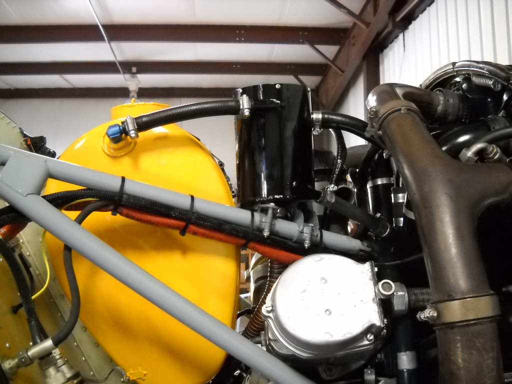

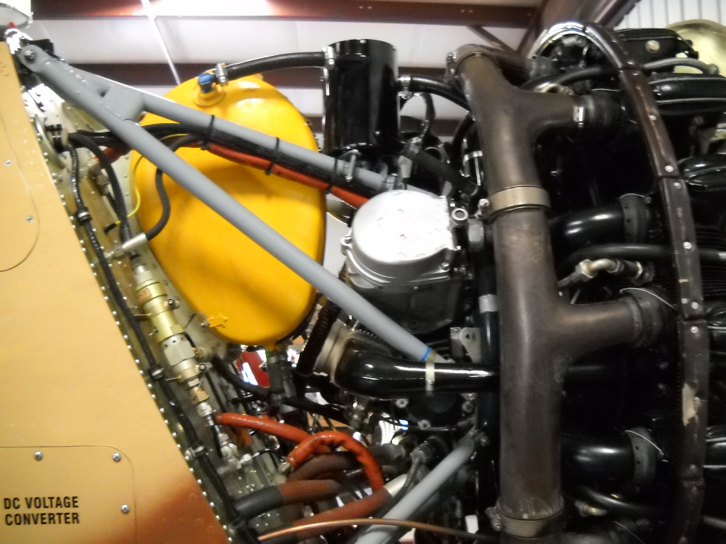

wlannon(at)shaw.ca
PostPosted: Sun Jul 12, 2015 7:45 pm    Post subject: Housai vents/breathers Reply with quote
You did not mention how the oil tank vent works with your system. The
stock vent pipe is internal and, of course, vents the top of the tank.
However any negative "G" will fill that pipeline which then dumps overboard
with positive "G".
As you see in the photos I have de-activated the original and vented the
tank directly to the separator. Negative "G" will transfer some oil from
the tank. The nose case and main case vents are joined with a 1" hose and
the main vent pipe is modified with a 3/4" nipple attached by welding. A
3/4" hose attaches that to the separator and a 1/2" hose returns drain oil
to the crankcase. The separator vent outlet is via a 1" SCAT type hose
exiting at the lower left firewall.
I have yet to see even the slightest trace of oil exiting the vent (it is
always bone dry) or any trace of oil on the belly.
The system works so well that one is tempted to negative "G". But this is
simply an air/oil separator, not an inverted oil system. Without an
inverted oil supply to the pump oil pressure is lost in seconds with ANY
negative loading. Extreme caution is advised.
Walt

wlannon(at)shaw.ca
PostPosted: Mon Jul 13, 2015 8:43 am    Post subject: Housai vents/breathers Reply with quote
Gil;
In the stock system the large, fwd. facing tube is the main case vent
outlet. Connecting the nose case vent to that means there is no longer a
vent unless you have provided another outlet. At minimum that would be a
connection to the oil tank allowing it's separate vent to handle the whole
system.
The separator is my own design. There are other good ones on the market
but location is very important (High & Hot) and the connections must be in
the right places.
Walt
