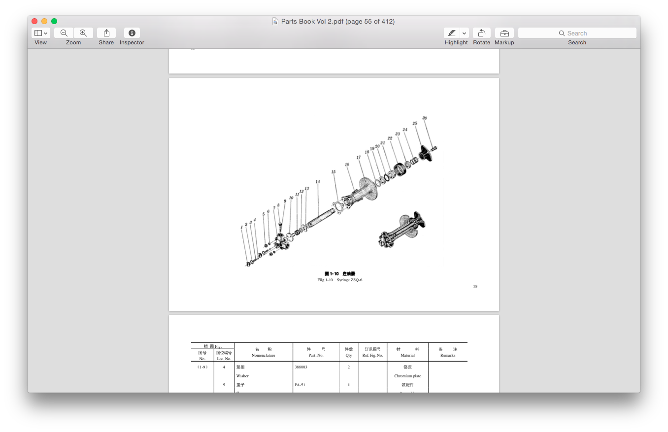

av8ter
Joined: 25 Apr 2015
Posts: 27
PostPosted: Sun Jul 19, 2015 7:59 am    Post subject: Re: CJ-6 Primer issues Reply with quote
schematic
