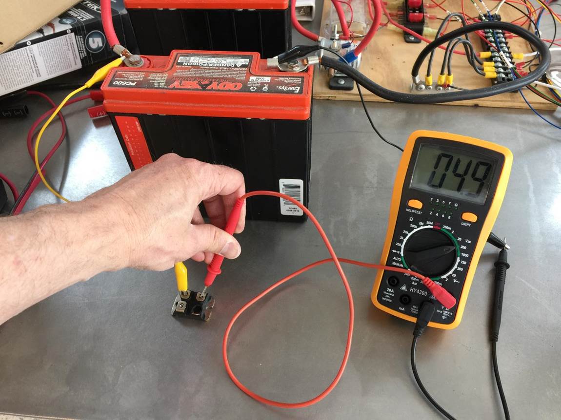

In general, if you leave the ground side of a circuit floating and measure from the floating ground to the actual supply ground, you will see some voltage (in some cases, the full voltage of the supply). For your voltage test of the diode pack, try inserting a 12V load (light, etc) in series with the diode, connected from the diode anode (your red test lead point) to the battery ground terminal. Measure voltage on the same points shown in your pic. I'll bet that the load (light) won't illuminate, and you won't see any voltage. All semiconductors have some leakage, but won't supply significant current because the leakage is so low. Your spec sheet says IsubR is 2 mA at 45 volts, so would be much lower at 12 volts.

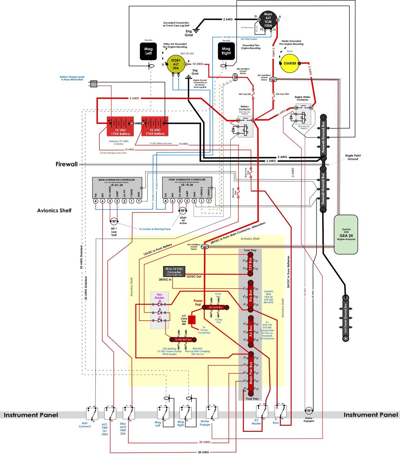

We’re getting set to do power on testing of our electrical system and avionics.  We’re using the (Bob’s) Z-12 power grid at 28 VDC with a 12 VDC bus and 12VDC hot battery bus.
We have schottkey diodes isolating the various buses.
With the positive battery terminal connected and the 12 VDC hot battery lead connected, but NOT the battery ground to the single point ground,  I checked the voltage at various points and saw the 12+ VDC where it should be but was surprised to measure about 3.5 VDC on the Main Bus and even the Ground Bus.
The meter set up was with the VOM meter ground lead to the battery ground (not connected to the airplane’s ground bus) and then the positive prove to the various measurement locations.
At first I thought we must have a pin out wrong in a connector somewhere – and maybe we do.  After some trouble shooting, I was able to determine that the voltage seems to be leaking in reverse past the diode from the 12 VDC Hot Batt Bus to the 12VDC Bus and then through the 24 to 12 VDC converter to the Main Bus.  But somehow, when I put the meter’s positive probe on the ground bus, it also shows 3.5 VDC.  So not even sure this is a valid way to test that I’m using…
Here’s our Power Grid.  Sorry Bob that it is in my pictogram format…  The anode side of Diode B is where I’m seeing 3.5 VDC with 12VDC on the cathode side, as expected, coming from the hot battery bus.
I did a test of a spare diode of the same model on the bench with a single 12 VDC battery and measure 4.9 VDC on the anode side of the diode with the cathode connected to the battery’s positive terminal.  See photo below.

This is the Schottky diode that I sell with an appropriate heat sink, and it's a great part. You could have contacted me, but this is a general interest anyway, so an answer helps everyone.
All standard voltmeters have a built-in load. This is as it should be. If they did not, then nothing would make much sense. For special purposes, voltmeters can be built with arbitrarily high resistance (or a tiny load, called impedance in meters, etc.), but they all still have some load.
All electronic parts, even relays and switches, have "leakage". Insulation can still be measured in ohms, no matter how good, (millions and billions of ohms...)
So if you built a simple switch with nearly perfect insulation and applied a voltage to it, a voltmeter with infinite ohms resistance would still measure a voltage "through" the switch...whether or not the switch was on or off! That's why voltages are not measured through switches, relays, and any other parts.
I note this in some of my literature, that a voltage measurement without a load will give meaningless results. A Schottky diode has a very low Vf forward voltage drop (lower than P-N diodes). This saves power, but the Schottky also has a greater reverse current "leakage". The reverse current typically won't leak enough power to light even the smallest LED, but some builders worry that this is a defect.
It really isn't. It's just reality.
