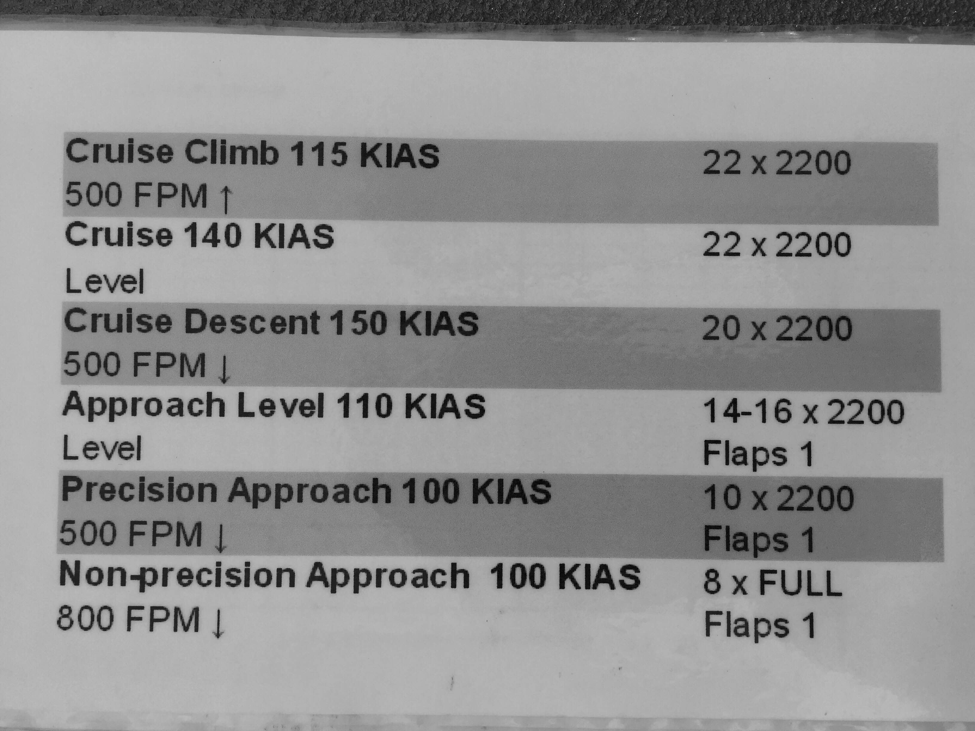

Yes, so today I had what I think was my first in-flight problem with my '10 and it resulted in a declared emergency and precautionary landing.  No big deal but an interesting experience.
Flying home this morning from Pittsburgh to Durham NC, we had entered IMC conditions as we approached a wad of early morning cells.  I requested a climb and a deviation in an effort to find  VMC before getting too close to the cells.   In the ever continuing effort to maintain hand flying skills with an extremely capable 2 axis autopilot, I decided to hand fly the plane and enjoy the challenge of flying to standard in light convective chop.
Flightaware Information
At one point I decided to let Tiger fly it for awhile so I could figure out my next move.  Tiger immediately began a diving turn so I switched him off and resumed hand flying. Figuring that I had missed one of the buttons during my transition, I did another Direct-to and made sure I was exactly on altitude before giving it back to Tiger.  Tiger performed another diving altitude excursion.
Both excursions exceeded 200' but they were not called out by ATC  (nor are they visible in the Flightaware track).  It took a minute or two to figure out what the problem was; I had lost an accurate airspeed indication.
This is not a particularly big problem other then it rendered my autopilot unusable (I have not yet explored whether or how my Trutrak unit could have been used in some degraded mode without a good airspeed indication).
I told ATC that I had a problem with my airspeed indicator and I requested vectors and a descent to VMC and a landing.  I was given a turn and a descent by the controller and was asked whether I was declaring an emergency.  I said "yes".  Very quickly a more sure voiced controller took over and directed me to lovely Lynchburg Regional.  I broke out into hazy VMC at 5,000' over familiar territory.  I fly over Lynchburg on many trips but hoped to never have to land there.
During the steep straight-in approach to Runway 4 I noted that both my GRT EFIS with dual AHRS and the backup airspeed indicator were giving erroneous readings.  Since they only share the pitot feed upstream of the dual AHRS connection, problem determination should be simple and is likely water.  I'll let you all know what I find.
Some thoughts:
  • I'm lucky and glad that the failure occurred while hand flying.  If Tiger had been flying, it could have been much more confusing.  Having said that, Tiger does 99% of my flying.
  • Declaring an emergency, even if done reluctantly, clears the mind along with the airspace.  Loss of airspeed in IMC  is no big deal but once detected, it's nice to be able to focus on flying the plane without other distractions (once you answer the standard 'souls on board' and 'fuel' questions)
  • I recall a few discussions regarding the '10's mechanical stall warning system.  Mine is in place and operational.  It was a comfort knowing it was there as a backstop during my approach and landing.  I'm glad I put it in.
  • Darn the '10 is a sweet plane!!
That's it so far.  Need to go fill out an ASRS report.

This brings up a great point and an excellent technique. During flight testing or at any point, it is a good idea to establish and have known pitch and power settings for different configurations and phases of flight. For instance, if you know that 2400 RPM, 18" of manifold pressure and 2 degrees nose high will give you 100 kts with flaps up, and that a notch of flaps, 15" manifold pressure and 1 degree nose low will give you a 600 fpm descent rate at 100 kts, you have an target to shoot for and it can help to keep you alive during these kinds of emergencies (no airspeed indication) where you can not re-enter vmc flight.
The Air Force, the Navy, civilian King Air medevac companies, and even my current job flying 747s all taught this concept of flying. Know your pitch and power settings and watch how easy flying becomes.

My CFII insisted that I test and make a card for various power settings and conditions. I used it "loose leaf" when I was training. It was so handy I incorporated it into my checklist. See attached photo. "Flaps1" means unreflexed, 0 degrees, etc. YMMV. --Dave

I made one up too but never stuck with it. I'm going to play with yours
for practice flights. Will probably convert to percent power and see
how it works. Thanks.
Fact is, in normal ops, I do one thing and am quite confident with it.
Practicing I do another. Not optimal, potentially a problem, need to
ponder further.
