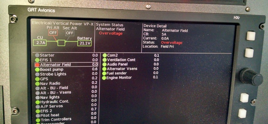

I'm in the process of trying to track down an over voltage fault.
So far the engine runs that I've been doing have been relatively short duration (mostly around 5-10min) while I'm getting the engine dialed in. On about 4 occasions I've noticed the alternator circuit has faulted for "over voltage".
I'm running a 28v electrical system
VP-X Pro
B&C LR3C voltage regulator
Kelly Aerospace 50a alternator
Continental IO-550 engine.
Vertical Power and B&C have had me check a number things. All checks have shown voltage levels, drops and wire resistance to be well within parameters.
B&C is recommending to pull the alternator and have it checked.
I"m just wondering if anyone has run into anything similar with these alternators before I pull it ship it out.

First step is to determine if you are actually experiencing a fault or just a bad indication.
Which system is giving you the over voltage fault error? The VP, an over voltage module, something else?
Do you have a digital volt meter that remembers the highest peak voltage?
-Jeff

As it has been explained to me, the voltage regulator is determining the fault. The VP-X is reporting the fault.
My meter has a hold feature but it's manual, not a peak hold.

That regulator uses the "crowbar" technique to handle an over-voltage condition. Which means that it will pop its own circuit breaker to shut itself off when buss voltage gets too high.
So, is it the case that the electronic circuit breaker in the VP-X which feeds the regulator is "popping"? (I'm not very familiar w/ the VP-X so I don't know how it indicates when one of its electronic circuit breakers pops.)
Does the VP-X have an alarm channel for Over-Voltage? If so, was that alarm triggered?

I'll try an answer with either what I know or what I've been told:
The VP-X monitors the system voltage. When it hits 32v, it shuts off the power to the field and reports an overvoltage fault. (see attached)
I don't know exactly where it's monitoring the system voltage. I would guess at it's connection to the system bus.
The only "adjustment" to the overvoltage trigger level is whether it's installed in a 14v or 28v system. On a 28v system, the OV trigger is hard set at 32v.
Vertical Power offered to bench check the VP-X. But since this is early in the game, I was hoping to get some more ideas and data before going down that road.
Speaking of data, I did run across this little guy:
DataQ Instruments DI-149
http://www.dataq.com/products/di-149/index.html?gclid=Cj0KEQjwk7msBRCJj67khY2z_NIBEiQAPTFjv9iqePcOkNiAMApB_amhAfmVZ-fp0KOI3tHOgpWA9VoaAnUa8P8HAQ
I'm wondering if it would be helpful to identify what's happening.

How are your LR3 and VPX system configured? The
LR3 is fitted with crowbar OV protection. If I
understand your symptoms, it's an OV sense and
protection function within the VPX that tripping?
Can you de-program the VPX ov function? Or raise
it's trip point to some big number? You don't need
TWO ov protection systems.

Alternators have bushes that ride on slip rings. If the rings are not concentric, the brushes will move up and down in their holders.
can you give me some idea of where I may have a disconnection in the "discontinuity in assembly of simple-ideas that govern performance
I get the impression that Bob is inferring that he does not trust the VP-X.
I suggest that instead of pulling the alternator, that you replace the voltage regulator with a generic Ford VR166 or equivalent. There is a list in Bob's book. The over-voltage and low voltage features of the LR3 are not needed in your application if the VP-X provides over-voltage and the EFIS gives low voltage warning.
