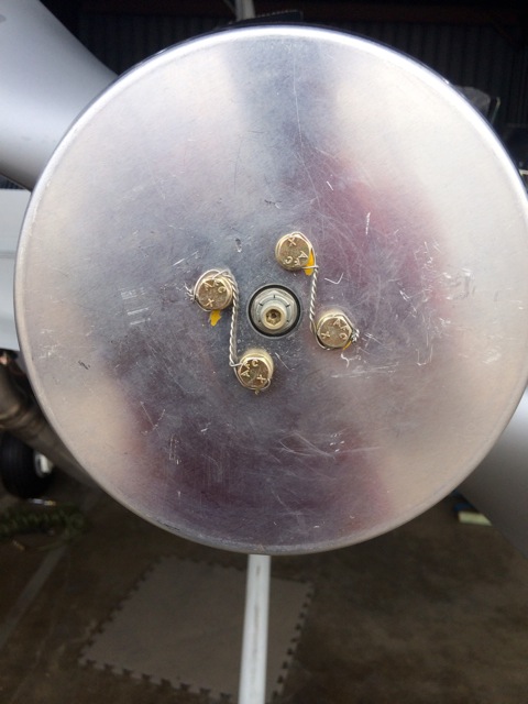

Vans says to torque the spinner front plate bolts per propeller manufacturers instructions. After 6 trips through the Hartzell manual I can't seem to find the torque value. As they are AN4's I've gone ahead and toqued them to 60 in/lbs and safety wired. Anyone know something I don't here?

[img]cid:BD9C2669-DDF1-4AF8-A747-B4B41695D0C2(at)attlocal.net[/img]

That'll work
You did well!
