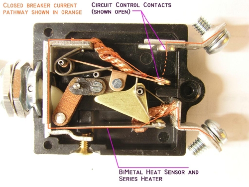

Why a breaker/switch? Those are loaded with mechanical
monkey motion to combine the functions. Rube Goldburg
would be proud . . . if you don't NEED the circuit
protection, then a plain vanilla switch is the better
choice.
[img]cid:7.1.0.9.0.20150611082213.0205e990(at)aeroelectric.com.0[/img]
 Filesize:  148.95 KB
 Viewed:  7789 Time(s)
