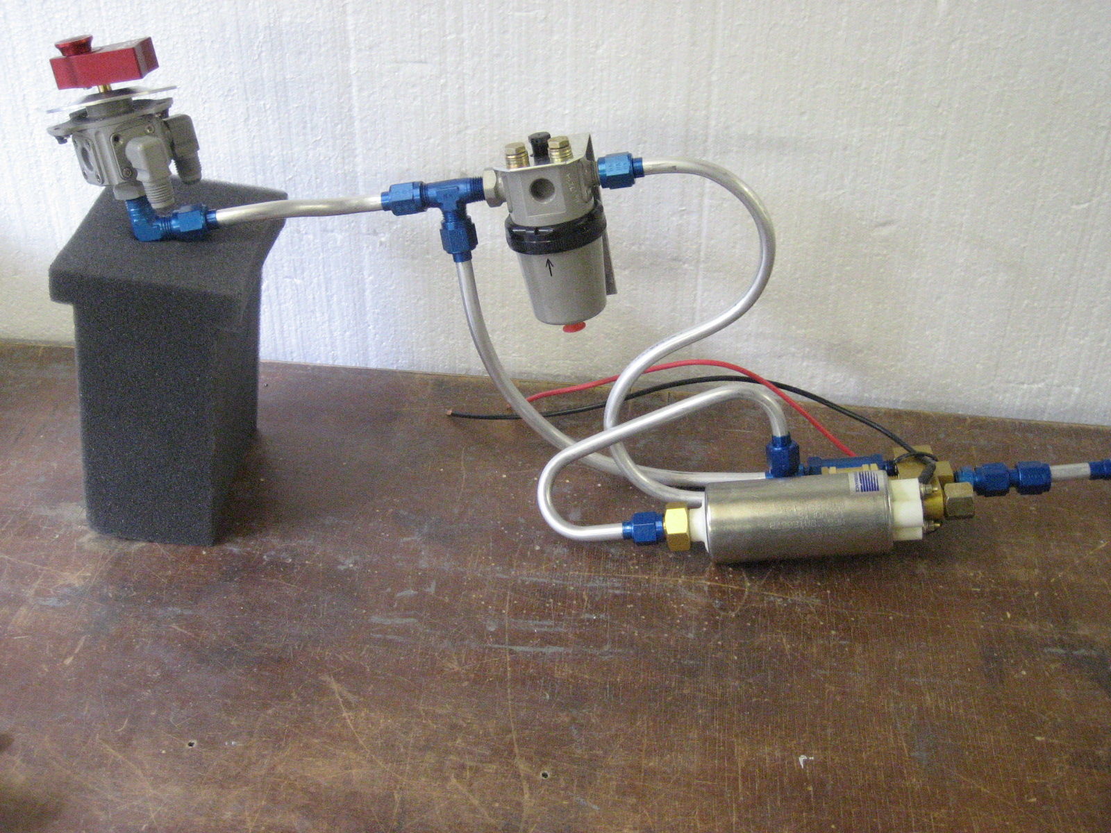

On 11.06.2015 09:14, Werner Schneider wrote:
Hi Dan,
in the UK there is a 10 flying with a gascolator in the setup before the fuel pump
[img]cid:part1.08070806.02010807(at)gmx.net[/img]
He has several 100 hrs without any issue, I plan to do the same just will have the Andair pump instead.
Makes inspection a bit easier as well.
Cheers Werner
