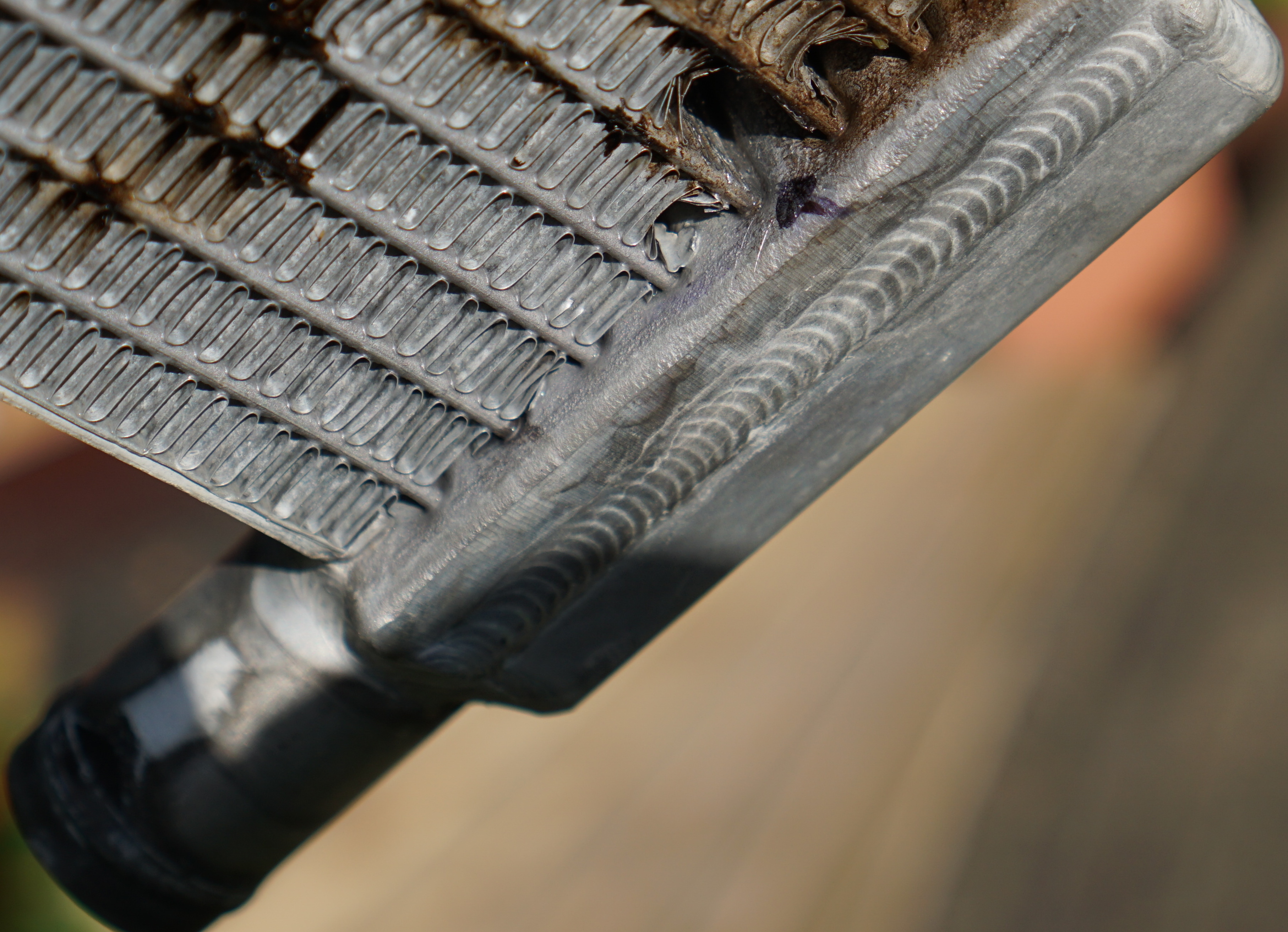

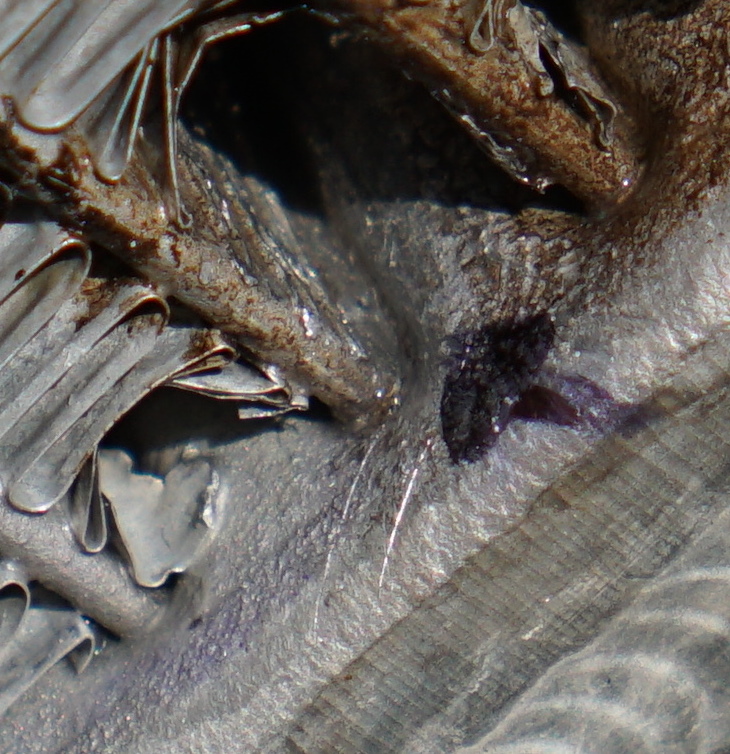

Any chance of a photo of the crack?

its more of a tiny crater or solder bubble; perhaps a manufacturing flaw. The brown is my stupidity, tired to get the engine hotter in winder, but putting some roofing joint tape over a bit off it, or course it was tar based and I had to remove with petrol (from the other side)

So I have a theory as to the cause and its linked to the weeping I used to get on shut down (from new) and the split pipe I had over the radiator junction. The radiator wasn't leaking in flight, it started when I shut down. When the water pump stops working and the engine is hot, from landing with the prop on fine and highish revs, the pressure builds up at this end of the radiator. Now I have clamped it all up and stopped any leaks its found a weak spot in a rad weld and made a small puncture.
I wonder if the cap needs to be a lower pressure one so it vents properly instead of knackering the rad?
