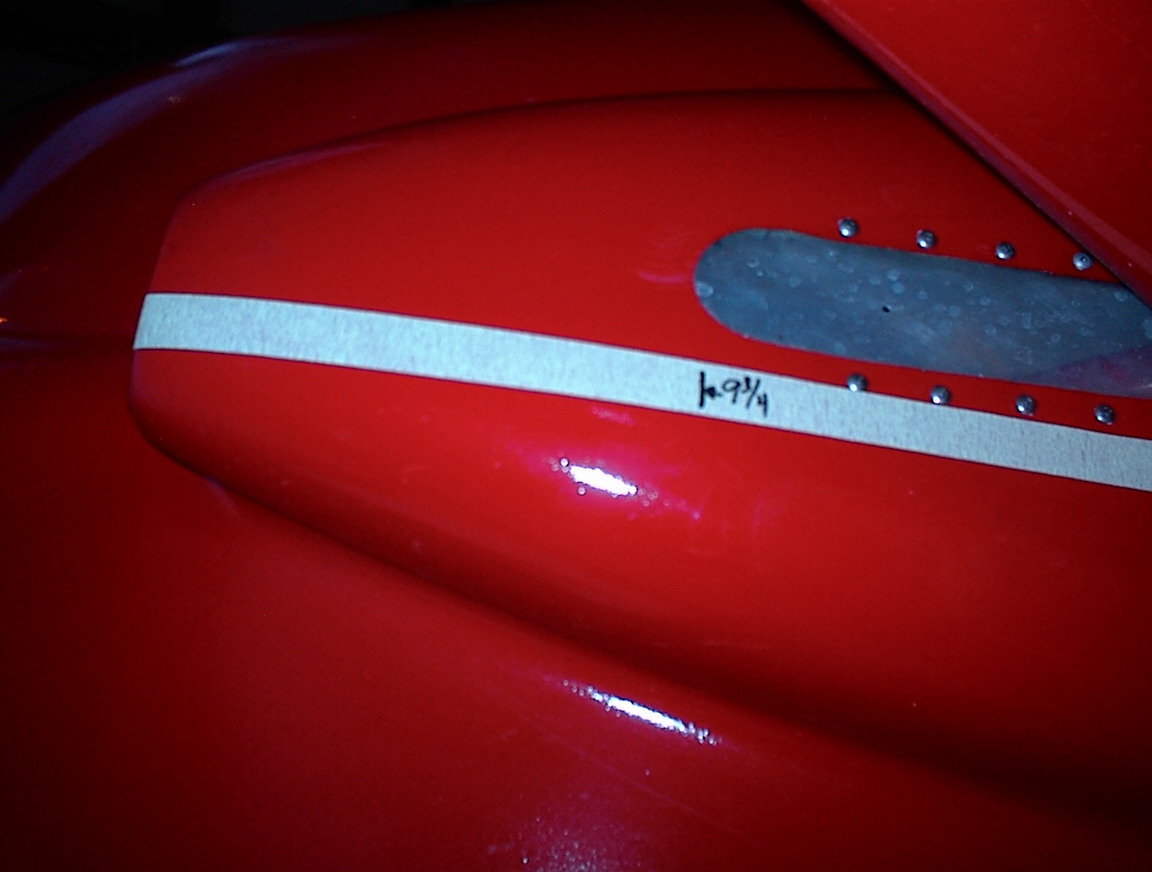

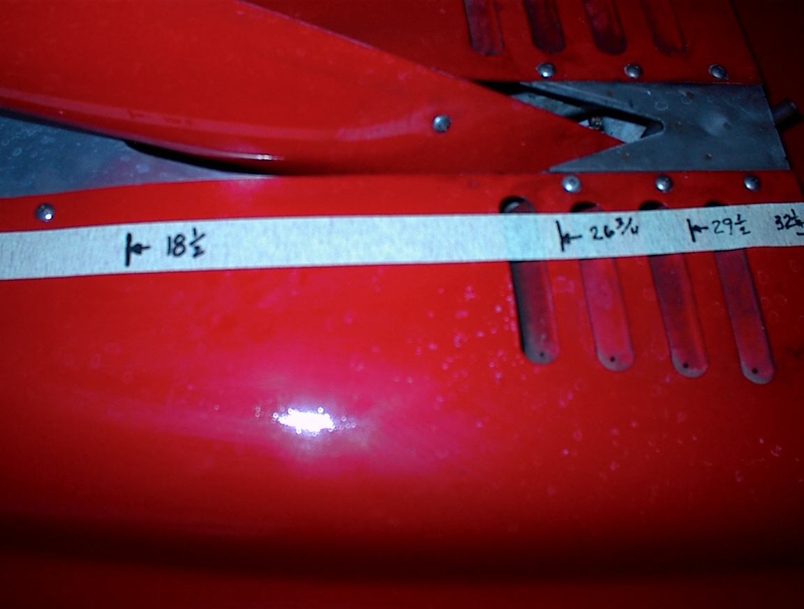

I lengthened the nose gear leg cutout in the bottom of my cowl to make it easier to remove and replace the lower cowl.  I want to construct an aluminum panel to cover the cowl material I removed.  Can someone tell me the distance between the rear of the cowl and the front of the cutout?  I forgot to measure it before removing material from the cowl.  Thanks..

This is what I did for my 3 bladed prop. The measurments are from the nose scoop heading aft even though the pics imply it was measured from the rear. I still have to hold the tail down to let the gear leg drop as much as possible and then protect the prop edges as I remove the lower cowl.

PostPosted: Wed Jun 10, 2015 5:34 pm    Post subject: Nose gear leg cutout length? Reply with quote
Awesome... thank you!
