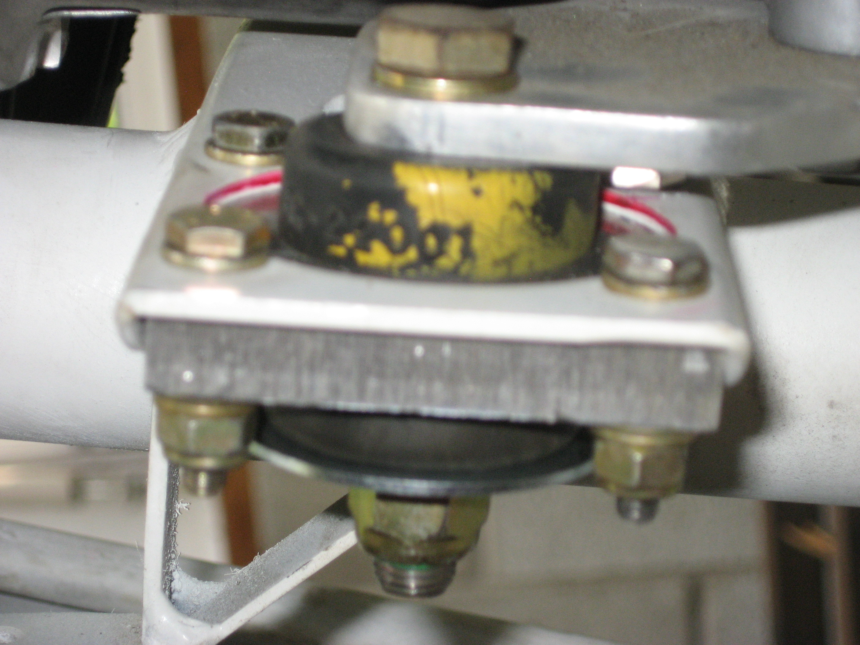

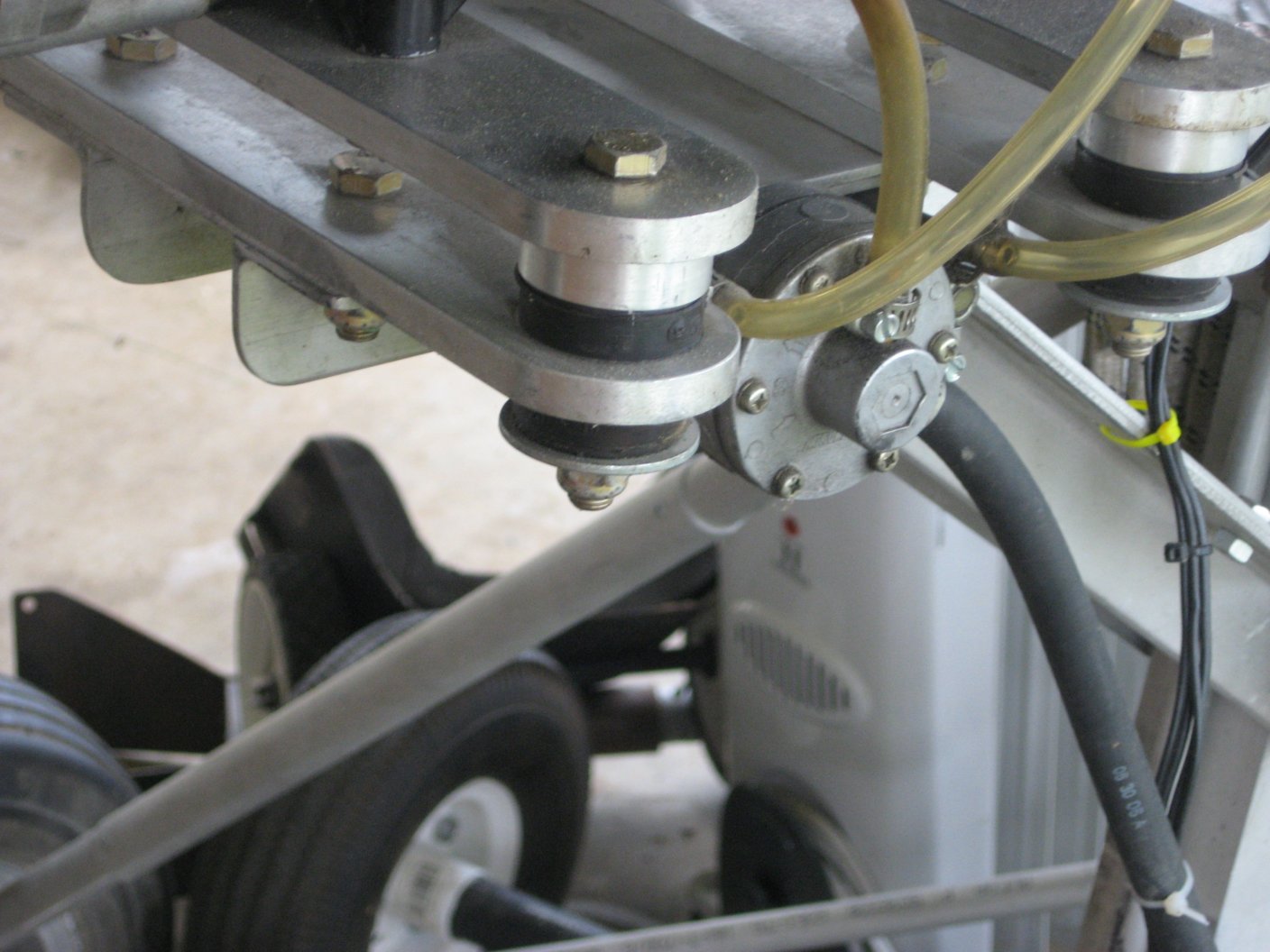

Talking to Travis...He indicated that motor mounts cost 45 bucks each..
$180 the set.
Here is my solution. I noticed that the Trike that I bought had the
two part rubber style...and having a box of those...I decided to make
use of them on the Firefly...Just a square of 6061 with 4 holes and a
large hole to accommodate the rubber through mount.... I have new ones
but managed to use some older ones , will change them out later on. Free
vs 180 bucks...I can handle that...
Frugal Herb
ps first pic shows the 503 mounted on a trike frame...second shows one
of the Firefly mounts...

~3/8" bolts?

7 dollars and change at Aircraft Spruce....37 and change for a set
including shipping...
