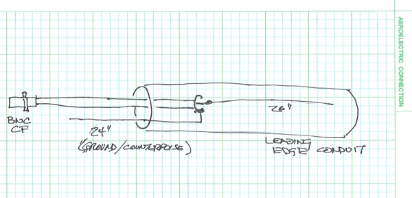

Jim, finished one of these and was disappointed in performance.
The thing is so tiny that it's hard to troubleshoot,
assembled a second just in case.
I think the best plan-b for now is to install
a quasi-sleeve dipole . . . except that the 'sleeve'
is just a piece of wire. I forget how long you said
your antenna conduit was, hopefully considerably
more than 26".
Make the antenna from wire stiff enough to push
into the tube on the end of the coax. Wouldn't
put a connector in the counterpoise. Just thread
it to the ship's interior on installation and tape
it sort out of the way.

Thanks for the reply and progress report. I was really hoping for a successful test, but yes...the immediate goal is getting the bird through Phase I.
The conduit is sufficient to install what you have described below. Maybe that will be enough?..I guess we’re going to find out one way or another.
I’ll report back with what we find in the coming weeks.
