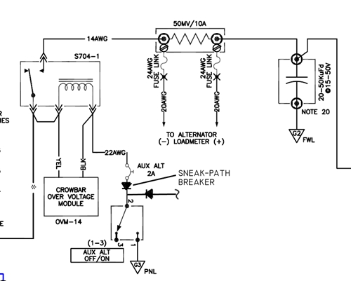

At 07:54 PM 6/7/2015, you wrote:
I wanted to install an LED "ON" indicator light for when I switch on the SD-8 alternate power supply. I rigged an LED so it works with the 12 Volt system and tried it on the switch which goes to ground for ON. It works fine when it is the only thing on the switch. When I hook up the SD-8 relay to it ( as wired for the original Z-8 diagram with NO self excite) which is also a switch to ground for on, the LED lights up even in the off position. Since the LED ground and SD-8 relay ground share the same terminal, my only explanation is that the LED is finding a ground somewhere along the SD-8 relay pathway. I have stared at the drawing until my eyes are crossed and can't figure out what's happening.
If I am interpreting your narrative correctly,
then for some reason, there is a 'sneak path'
to ground with the switch open. One fix for
this phenomenon is to add a diode in the relay
control lead that breaks sneak-path to ground
looking at the relay.
[img]cid:7.1.0.9.0.20150608075201.01f02418(at)aeroelectric.com.0[/img]
The 64 dollar question is where the sneak-path
is coming from. As shown, I too am unable to
identify the problem . . . UNLESS . . . your
SD-8 is not tied to the always-hot side of
the battery but instead tied to the switched
side and is finding a sneak path through the
system components on the main bus.
