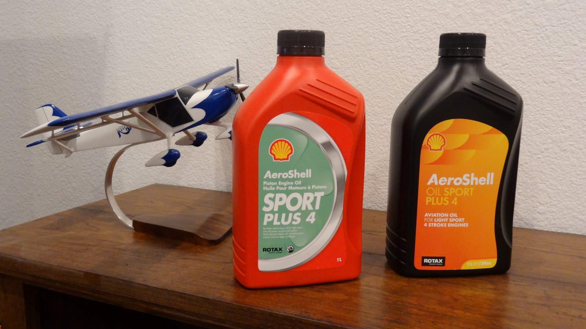

PostPosted: Thu May 28, 2015 8:52 am    Post subject: Kitfox IV / 912 Oil and water quantities Reply with quote
FYI… Service Instruction SI-012i-001R3 912-016R8 914-019R8 Selection of Suitable Operating Fluids.
Notice the notes: pg 3 of the pdf. There is a completely new formulation of the Aeroshell Sport +4 product. It is in a Red bottle. The old formulation (black bottle) can be used until the expiration date.
Side Note: We have been running the Sport Plus 4+ since the introduction on the factory aircraft and on 3 flight school aircraft. No adverse effects or issues. The flight school aircraft are running 80+ hours a month.
And yes… Rotax does get a return on the Aeroshell Sport +4 product.. The Aeroshell Sport +4 is also manufactured in the UK.. was told the kickback was because of the testing an time invested by Rotax in conjunction with Aeroshell and therefore Aeroshell is the only oil that can display the Rotax name and Logo.
Fly Safe !!
John McBean
Ph 208.337.5111
www.kitfoxaircraft.com
"The Sky is not the Limit... It's a Playground"
