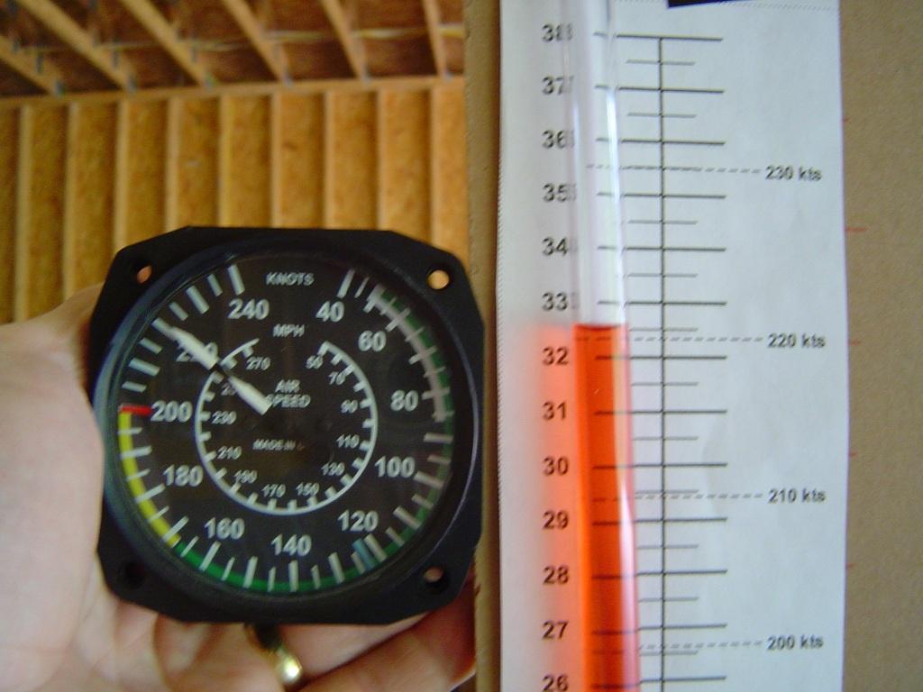

Here is a PDF file with a scale that translates inches of water to knots. This simple rig is very accurate. It also serves to find pitot/static leaks before you have the guy on the clock doing your biannual check.

 Filesize:  87.08 KB
 Viewed:  9590 Time(s)

Are they both connected to the pitot static system or does one just give you GPS speed? If they use the pitot static, and the plumbing is leak free, there is a calibration issue with one of them.
You can check the airspeed on the ground with a water manometer.
