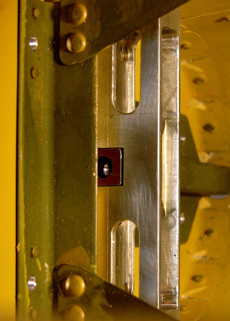

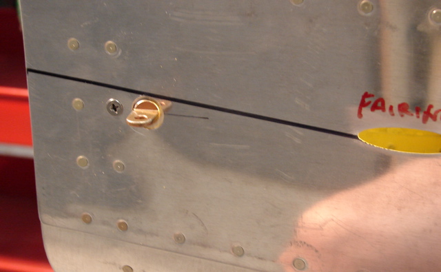

This is my rudder gust lock. I machined a part that bolts to the aft
bulkhead/vertical stab spar assembly. The eye-bolts protrude thru the skin
and there will be pins that lock the rudder in neutral position when
installed.
