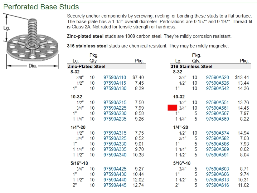

McMaster-Carr has these devices. Not sure I could
manufacture and sell for any less. These should do
the job for you.
[img]cid:.0[/img][/b]

Those are devices made by Rotoloc (rotoloc.com).
They used to be carried by Mcmaste carr but I don't see them in the current online catalog-- perhaps they still have them and the omission was an over site. I used lots of them of various lengths and diameters.
the mfgr should give you a dealer, or at least a distributor.
Rich

Thanks, McMaster-Carr has them, as Bob said.  Just ordered some.
They're not identical to the one I was asking about, but will serve the purpose just as well as the "originals".  Probably more substantial, too.
http://www.mcmaster.com/#perforated-base-studs/=xa5g0j
As for Rotaloc (the correct spelling) they do apparently make them.
http://www.rotaloc.com/products/bf/bf_m1_main.html
Thanks to all!
Ron

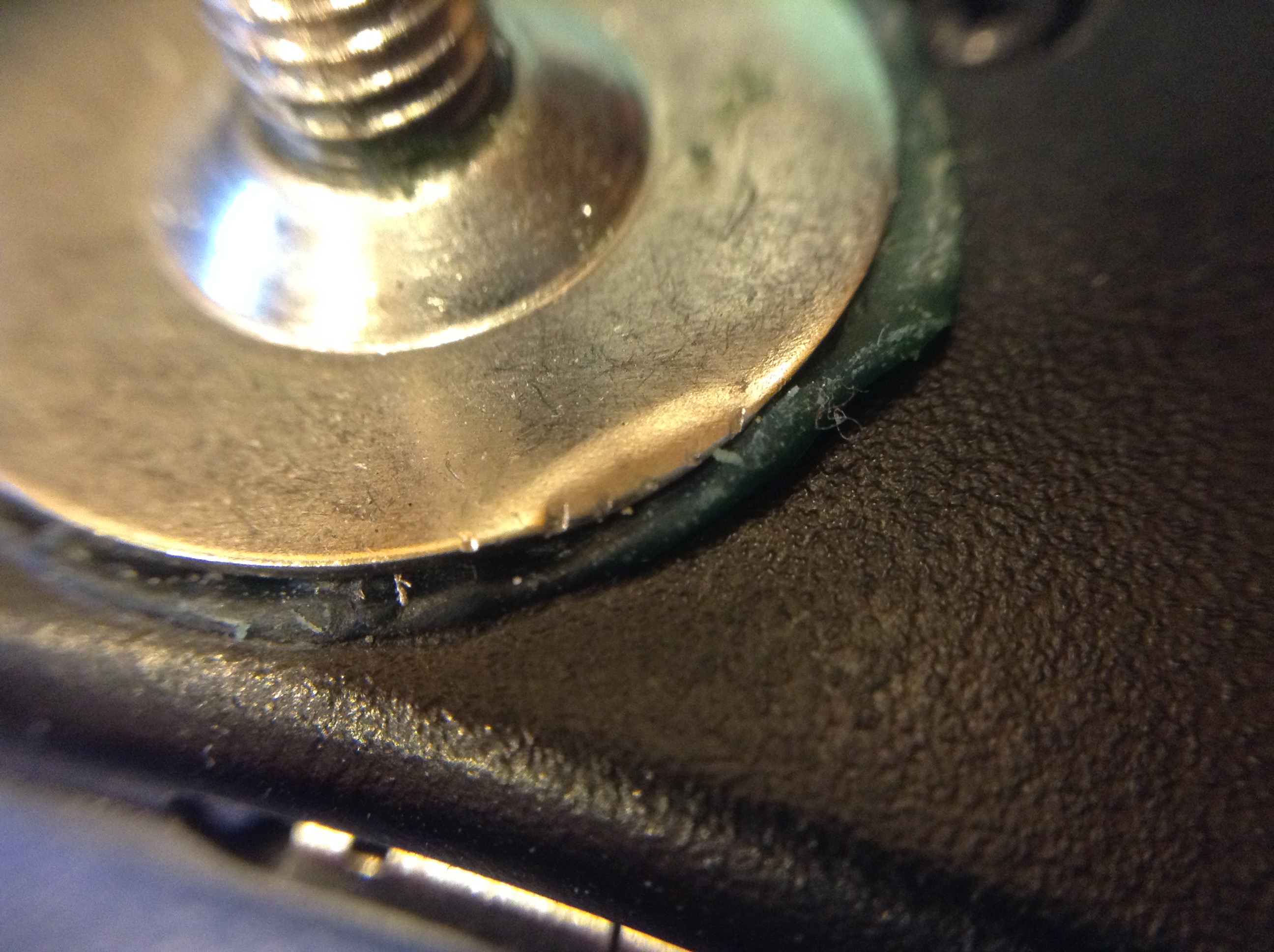

I've had pretty good luck using a flathead screw pointed up through a large-area countersunk washer:
http://www.aircraftspruce.com/catalog/hapages/nas549washers2.php?clickkey=14605
I scratch up the washer with some 80G.  Then dab a little adhesive in the countersink and the bit recess after most of the threads are through.
--Dave
--Dave

I fiddled with that process a bit. The biggest 'risk' is
to end up with a stud that is not firmly fastened to its
base. If the builder wishes to use metallic lock nuts on the
stud, it can really ruin your day if the stud twists on its
base after it's glued down to the airframe.
I experimented with several techniques for securing the stud
to the washer that included high strength epoxies under the
head of the stud-screw, in the threads just under the head,
in the threads and under the faying surface of a retaining
nut on the away-side of the washer.
Even sliver soldered a few. Strength was great but finish
was ugly.
I was able to achieve attachments that offered a twist out
resistance about 2x the torque needed to drive the metallic
lock nut. But the process was labor intensive. I didn't think
I could compete well with those parts from McMaster.
If I stumble across any more attractive options, I'll bring
them to the list muy pronto.
Bob . . . [quote][b]

I agree, the MMC solution is quick and easy.
FWIW, a few more details:  I was able to find some Hysol in cartridges that looked and smelled like the stuff that comes with clickbonds called Hysol/Loctite 8000.
Also, I recall bending the edge of the washer slightly in 3-4 places with some duckbills. Picture attached.
That prevents squeeze-out of the glue under the washer's flange, and allows for a little cavity between the washer and the screw.
Of course the customer is always right, so they must have had some pretty good glue (insulation?) to justify metal locknuts so close to the adhesive Wink
--Dave
