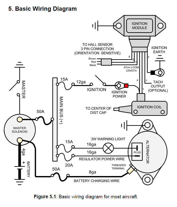

Does anyone know of of a situation where the Tachometer output of the Rotec E-Mag ( Square wave ) is hooked to a Dynon EMS?
I can not get the amplitude of the signal from Rotec and Dynon says it must be 12 v and not more than 50.
Bobby

What model Dynon EMS are you using? The SkyView EMS has both a high voltage and a low voltage tach input. The high voltage input can come from a "P" lead with a 30K resistor. The low voltage input can be less than 12 volts.

I am trying to tie my Dynon DEK - 180 ( 2007 vintage) Pin #32 Green / White RPM Left into the Tachometer output ( Pin 7 Square Wave ) of the Rotec E-Mag.
I can not get a go or no go from either Dynon or Rotec.
Any help would be appreciated.

The safe way to hook it up, so as to not risk damaging anything, is to use a 30K resistor in series between the ignition pin 7 and the EMS pin 32. If the D-180 does not display an RPM, then look at the signal with an oscilloscope or digital meter that reads peak voltage.
Or you could use the trial and error method. If the tachometer does not work with a 30K resistor, then remove it and connect ignition pin 7 directly to EMS pim 32. Looking at Rotec's documentation, my guess is that the tach signal is not high voltage.
http://www.rotecaerosport.com/faqs/ign-plug/

Even if the amplitude of the square wave from the Rotec tachometer is less than 12 volts, someone on this list can design a simple transistor amplifier that will boost the voltage above the minimum required for the Dynon D-180 tachometer input.
