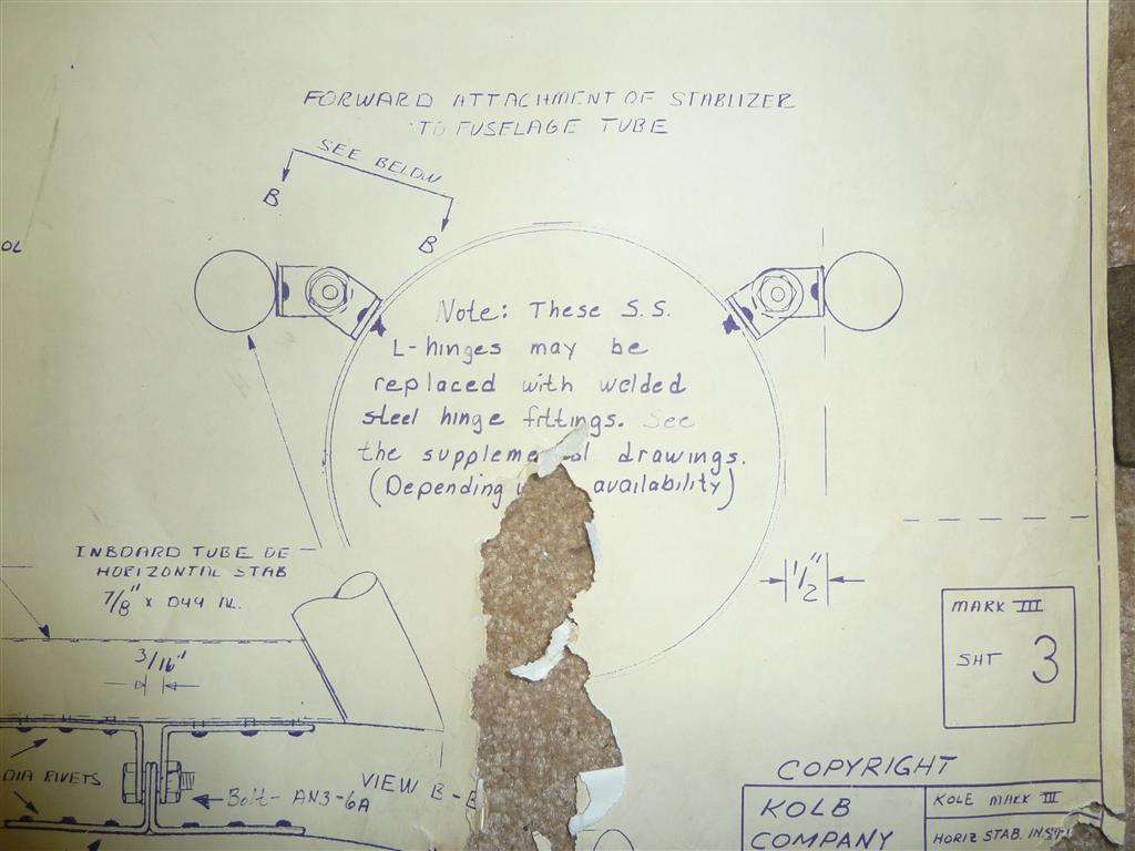

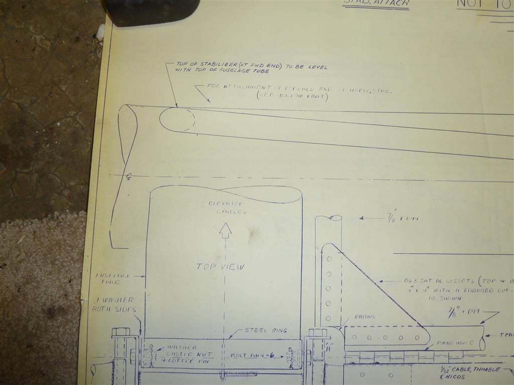

Richard Pike
Joined: 09 Jan 2006 Posts: 1671 Location: Blountville, Tennessee
Posted: Thu May 14, 2015 5:47 pm Post subject: Re: Horizontal stab position |
Dude, I'll do you better than that: here is what's left of the blueprints that tell you exactly where they are supposed to go. The front of the horizontal stab is even with the top of the boom tube.
Caveat: this is for the MKIII Classic.
Parts of the blueprint are missing: the mice got hungry.
True story.
