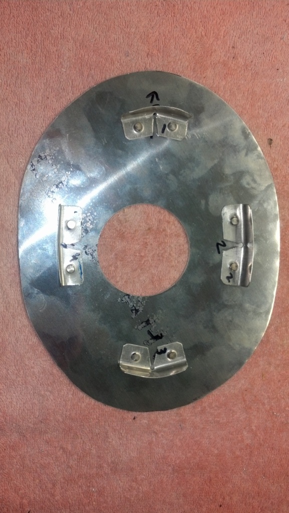

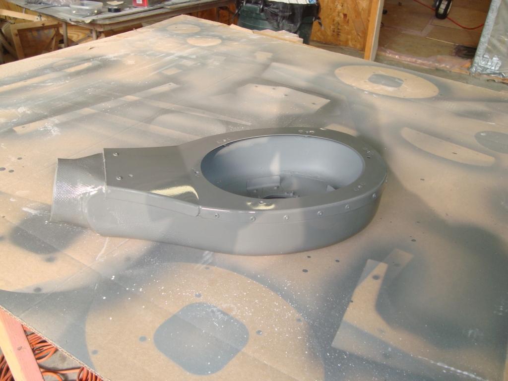

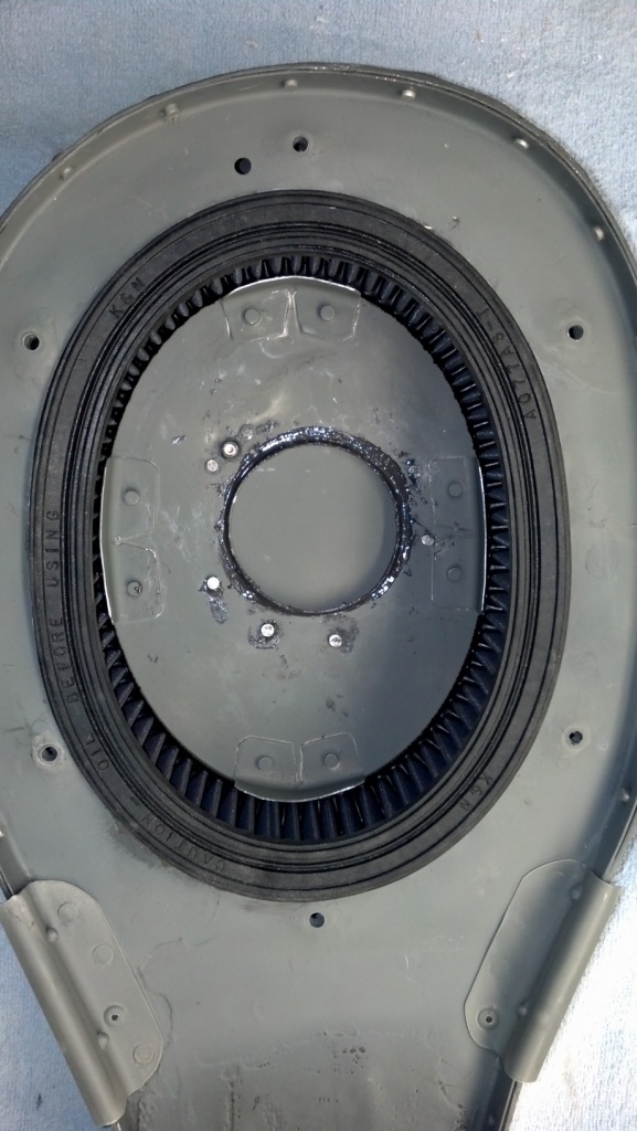

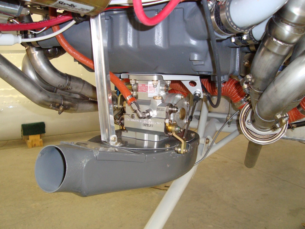

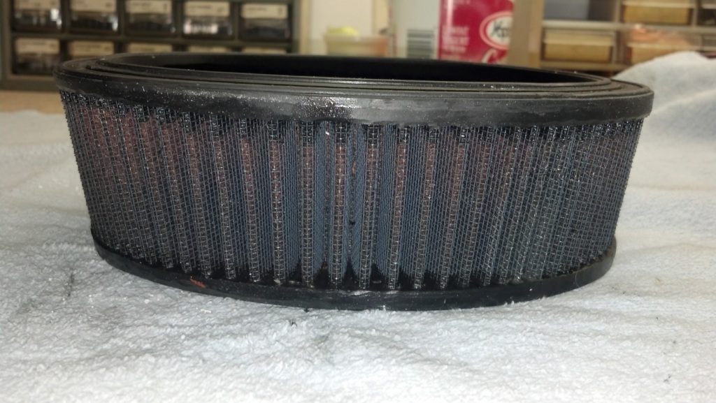

I posted a note on this awhile back.  As Tim Olson says, the air box needs an aluminum plate between the bottom fiberglass and the air filter.  Without it the air filter will wear away the bottom of the box.  After re-glassing the air box on the RV-8A a couple of times I figured this out.
The other problem is the filter will deform with time as there is no structure in the box to hold the filter shape – the filter bottom tends to shrink making the filter more conical than cylindrical (see photo #1).  Adding the aluminum plate also provides a way to solve this problem using simple brackets, and adds reinforcement to mount the alt air control door (second photo).  On assembly I added some Pro-seal between the bottom of the air box and the aluminum plate.  The alt air door rivets sandwich the fiberglass between the plate and the door flange.
The third photo shows the now fixed air box for the RV-8A (using the same K&N E-3450 filter as Van’s provides for the RV-10.  The fourth photo shows the air box I made for the RV-10.  You’ll note the top plate is inverted.  I did this to allow using the K&N E-1000 filter instead of the E-3450.  The E-1000 filter is 3” tall as compared to the E-3450 that is 2.5” tall.  Note this photo was taken before I added the notch on the left side of the box to provide clearance for the control linkage (last photo).
Carl

I finished the FAB this weekend, and after it was all said and done, I have about a 3/32" gap between the air filter seal and the fiberglass housing.  I think the fiberglass bowed out a little after I finished riveting.
Options I am thinking about:
  1) A bead of RTV around the circumference of the filter.
  2) Use aluminum and try to build up some kind of lip around the air filter
  3) Live with it as is
Any ideas or recommendations?
Vernon Franklin

Either ProSeal or fiberglass epoxy it in. I also see no issue using countersunk rivets with the shop head on the outside.

Thanks for the detailed photos and ideas.
I definitely think the aluminum plate protecting the fiberglass housing is
the right answer.
After Tim's comment of the fiberglass wearing out over time, I am surprised
that Van's has not addressed this as an AD on all models.
Vernon

I agree. I have seen planes that came in for inspection where the filter was about ready to fall through the bottom of the airbox.

Vernon,

I built a tight fiberglass lip around the bottom that covers the bottom rubber part, around a 1/4 inch tall, so the filter doesn't move around much. When the filter is new it fits perfectly, and after about 50 hours it shrinks both in height and circumference. So if you are still building make sure that it fits tight at least in height because it shrinks over time. I got a new filter thinking oh well the other one was already a few years old, just sitting there. The new one also shrank in 50 or so hours.
Looks like I also need to add a plate to the bottom. The problem I see with Epoxy, not sure about proseal, that it will have a hard time sticking to the already fuel/oil soaked fiberglass.
If that piece of aluminum gets unglued, it will rub a hole real quick through the fiberglass bottom. I'm thinking rivets with washers under the shop head (on the outside) would work better than glue.
Lenny
