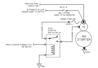

I'm not implying that there are not alternatives
based on other system constraints. For example,
this image . . .
. . . is found in figure Z-22 of the book. This
was a system driven 'fix' for the starter run-on
phenomenon observed when PM motors were becoming
popular. In this instance, one was required to
use the built-in contactor . . . so a buffer relay
was added to isolate the starter switch from
solenoid abuse.
This approach could be applied for ANY form
of starter motor thus eliminating the external
contactor. Given that the B&C starters were
going into both OBAM and TC aircraft (already
fitted with external contactors) we elected
to recommend external contactors as a matter of
common practice . . . B&C starters did not
have PM motors. The switch supplied with B&C
starter installation kits was pretty robust but
NOT suited to drive the starter's build in
solenoid-contactor.
So the short answer is, you can certainly eliminate
the external contactor . . . but it's a good idea
to know how that decision may create ripples
in the rest of the system.
