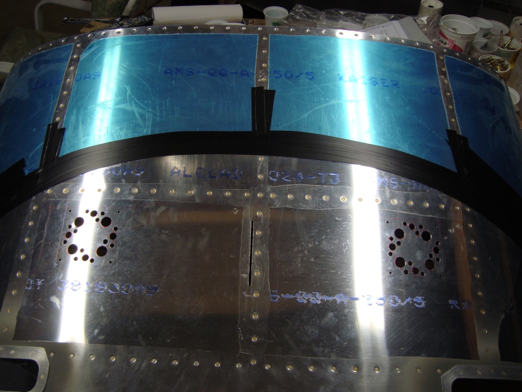

Attached photo is what I did. Works well. The hole pattern eliminated the
need for a screen.
I got a dozen or so 3", 0.12A, 12vdc brushless muffin fans from EBay for
perhaps $1 each. You want enough fan to move air, not create a tornado. A
single 2" fan worked well in the RV-8A.
Even with the fans off the heat from the avionics and cabin heat will come
up though the holes. I tend to use the fans more in summer to add
additional cooling for the avionics than in the winter for defrost - but on
the few occasions I needed to defrost these were more than adequate.
Carl

PostPosted: Sun Apr 26, 2015 6:21 am    Post subject: Windshield install & defrost fans Reply with quote
It really depends on your panel layout. Mine are about 4" off center. Since I have an Aerosport panel, the right one is over the comm stack. You just need to ensure clearance and have an understanding of the likely heat sources.
While the fans are fairly standardized, I would buy them now to ensure the proper size.

PostPosted: Sun Apr 26, 2015 6:35 am    Post subject: Windshield install & defrost fans Reply with quote
What Bob said....
There really isn't a standard size, so it's best to find your fans and then drill the holes to match. When I got my fans I bought a 3rd just to keep in a cabinet for the day when one of the two in the airplane quit working.
I have two fans that are centered between the center rib and the side ribs. Using the Aerosport panel, that put one over the radio stack and another behind my PFD/MFD.

PostPosted: Sun Apr 26, 2015 8:18 am    Post subject: Windshield install & defrost fans Reply with quote
Be careful here, you might run into problems like the Turbo Encabulator.
You have to worry about problems with Modial Interaction.
Here is a reference: https://www.youtube.com/watch?v=rLDgQg6bq7o
If Vans thought it was ok to have these fans, they would have put them in
the drawings and included cheap fans in the parts bag.
I used two 80mm fans. Worked fine when needed for defrost, but as mentioned
by others, I use them more for airflow on hot days.
