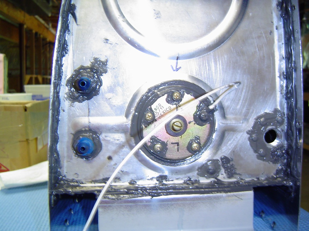

PostPosted: Mon Apr 20, 2015 5:53 am    Post subject: Fuel Return Line Location? Reply with quote
Berck,
I added a 1/4" purge line return to the left tank when building in case I
ended up with an AFP injection system (photo attached). This is the same
location I used the RV-8A which had AFP injection.
Adding a return line is straight forward and if you get the fitting in about
the same area as the vent line connection you should not have an issue. I'd
keep it high (like my photo) so that it is away from the fuel pick up -
should help with pulling cooler fuel into the engine as compared to the
hotter return fuel.
Just curious - how much did this EFII system cost?
Carl

[quote] On Apr 20, 2015, at 9:49 AM, Carl Froehlich <carl.froehlich(at)verizon.net> wrote:
Berck,
hotter return fuel.
Carl

PostPosted: Mon Apr 20, 2015 8:04 am    Post subject: Fuel Return Line Location? Reply with quote
Carl- thanks so much for the picture.  I'll plan on the same location.  As for the cost: We haven't purchased anything yet, and probably won't until we source an engine.  Hoping available systems will only get cheaper, but cursory research indicates it'll cost not much more than more conventional FI and ignition setups.
hotter return fuel.
> building in case I
> is the same
> fitting in about
> an issue. I'd
> pick up -
> compared to the
> hotter return fuel.
> Carl
hotter return fuel.
Carl

Carl, your return line seems to be in the same general vicinity as
these, and they say they have spar interference?
http://www.vansairforce.com/community/showthread.php?t=122839
How were you able to be sure that yours cleared the spar? Am I just
looking at this wrong?
Berck
PostPosted: Mon Apr 20, 2015 6:27 pm    Post subject: Fuel Return Line Location? Reply with quote
Don't know. I never used the purge return. The fitting is capped off with
an AN cap in the event I ever want to use it. As the plane is flying this
must not have been a problem. Taking the plane down for conditional
inspection next month so I'll look. I do note that the photos from the
Van's Air Force link have the return line further aft than I do. That said,
there is no reason not to place the return line fitting more forward on the
rib to make sure - like just forward of the fuel sender and about center on
the rib. Just make sure you mind the aileron connecting arm.
Carl
>> building in case I
>> is the same
>> fitting in about
>> an issue. I'd
>> pick up -
>> compared to the
>> hotter return fuel.
