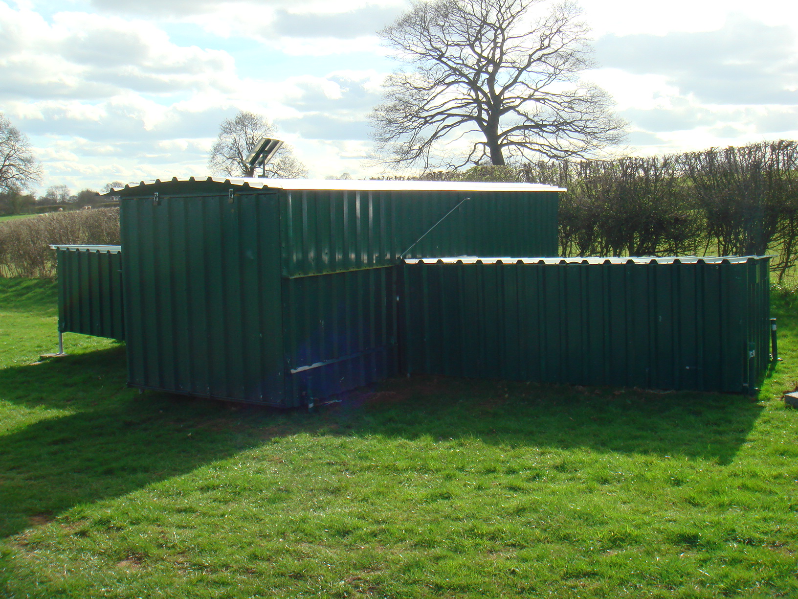

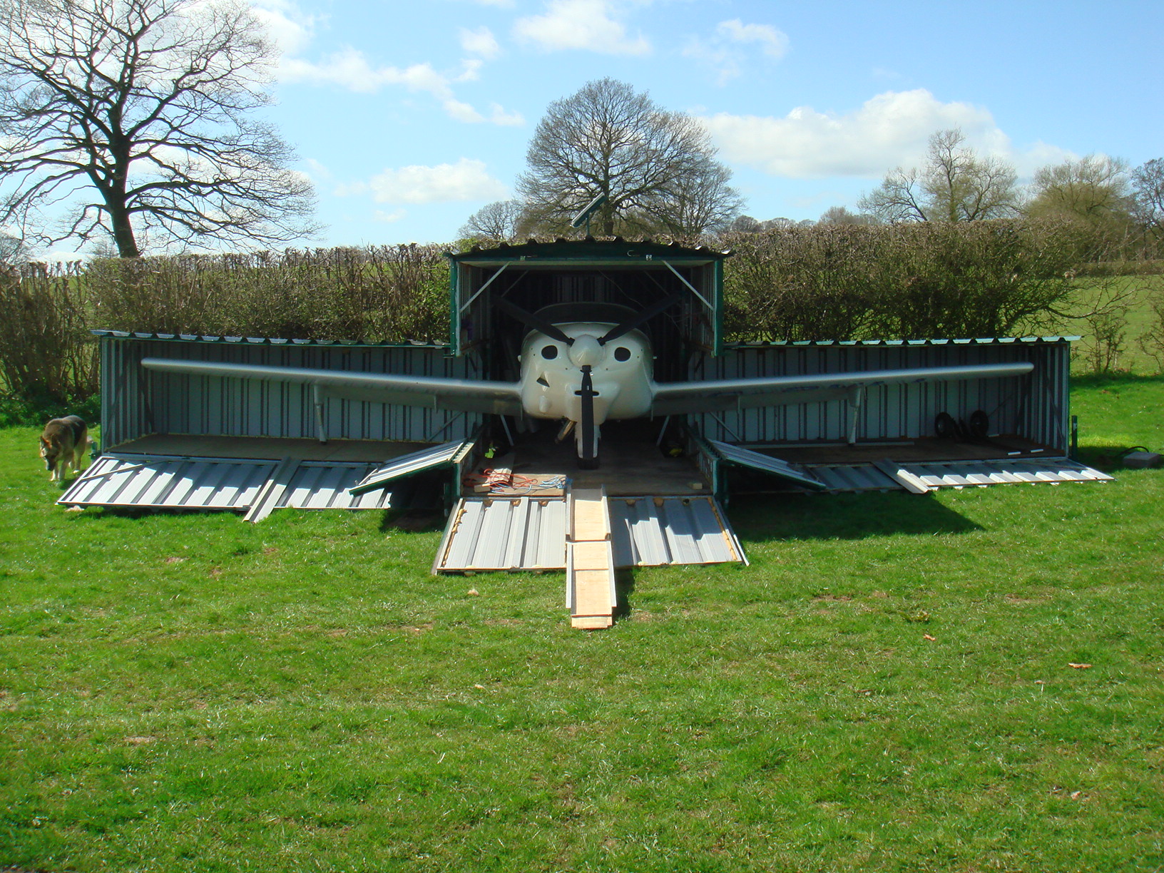

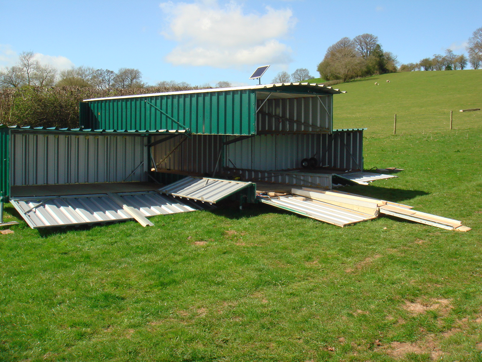

Hi All
I built a mobile T hanger a few years ago, in the hope of renting a field nearer to my home, this has not happened. I am at a lovely strip with good hanger and very friendly owners , but too far away. With their cooperation I have put the T hanger there rather than sell it. The two wing boxes are detachable and movable on a separate trailer, the main body is jacked up and the wheels put on and is towable behind my car. I have an electric winch to pull the plane in after removing the tail feathers. The solar panel keeps the plane and winch batteries topped up. There is another access door by the tail.
I thought it might be of interest.
Roger G-BWIJ

Roger,
Hats off to what seems to me to have been a very economical solution to keeping your plane fully assembled and out of the weather…the solar panel takes the cake…and I see your guard dog provides active security!
F.
