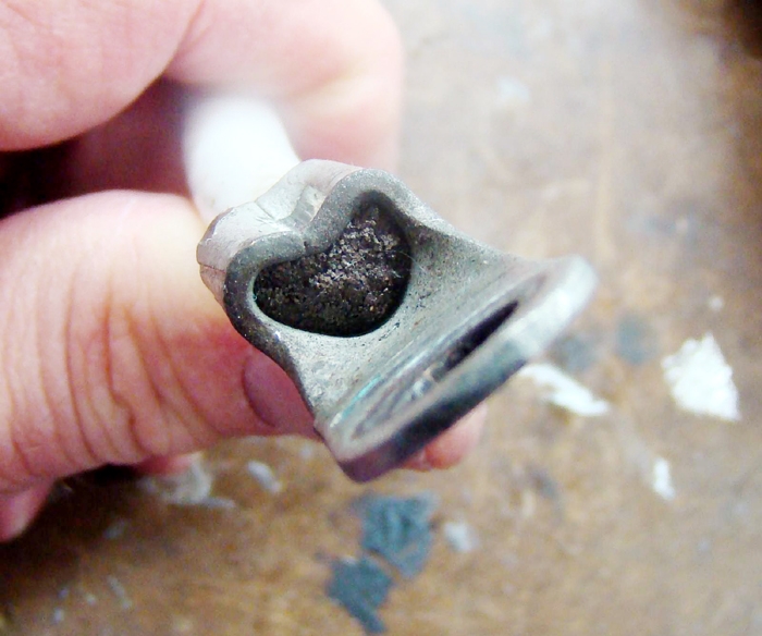

The jumper between forest of tabs ground on fire wall
hand been fabricated with a less than ideal crimp
tool.
[img]cid:.0[/img]
I did some voltage drop tests across the crimp joints and
found pretty high . . . about 2.5 millivolts at only 10 amps!

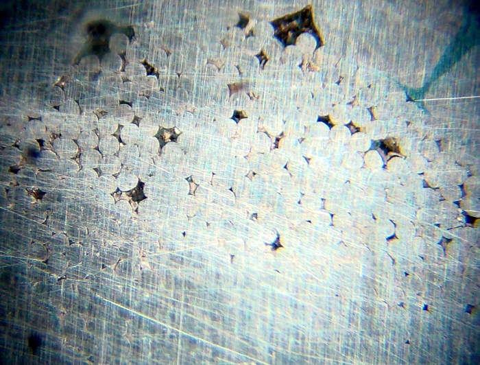

Cross-sectioned crimp joints examined under the microscope
showed numerous areas of 'failure to achieve gas tight' across
the face of the cut.

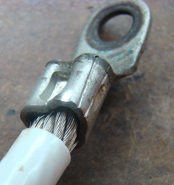

[img]cid:.2[/img]
My findings suggest some value in replacement of all terminals
applied with this tooling. I am also concerned with the corrosion
ring around the hole in the terminal . . . this should at worst
be slightly darkened tin plating. The degree of corrosion and
pitting of the mating surface suggests that this terminal was
not made-up with sufficient force to achieve gas-tightness
in the joint.
If you don't have access to a hydraulic tool and proven die
to install a terminal, then consider soldering your terminals
on per the article at:
http://tinyurl.com/qh4k7ko

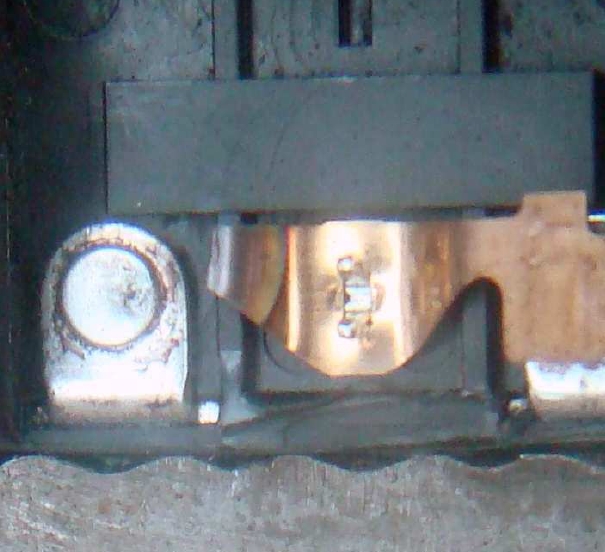

Interestingly enough, it was failure of magneto p-lead switches
that brought the deficiency to light.
[img]cid:.3[/img]
As you can see above, the phosphor bronze rocker strut that held
the moving contact was burned in two. The fixed contact is in great
shape but structure that supported the moving contact fused.
The moving contact was free to rattle around inside the switch.

In this and in similar threads, Bob N. has provided excellent instructions on how to achieve gas tightness with wire terminals, but I would like to add some additional info.
Some types of crimp tools press a single indentation into the barrel of the wire terminal. This may not be ideal, but generally will suffice; however there is one mistake very commonly made with this type of tool. Most inexpensive wire terminals are formed from flat material and have butted ends at the barrel (wire insertion point). If the crimp tool applies an indentation over the barrel butted ends as in the photos, a poor termination is almost guaranteed.
If it is late evening and the only crimp tool that you have in your toolbox presses a single indentation into the wire terminal, take a close look at the terminal barrel to see if there is a seam (butted ends). If there is a seam, apply the indentation on the opposite side - not across the seam as in the illustration..., or use better quality wire terminals formed from tubing without butted ends.
