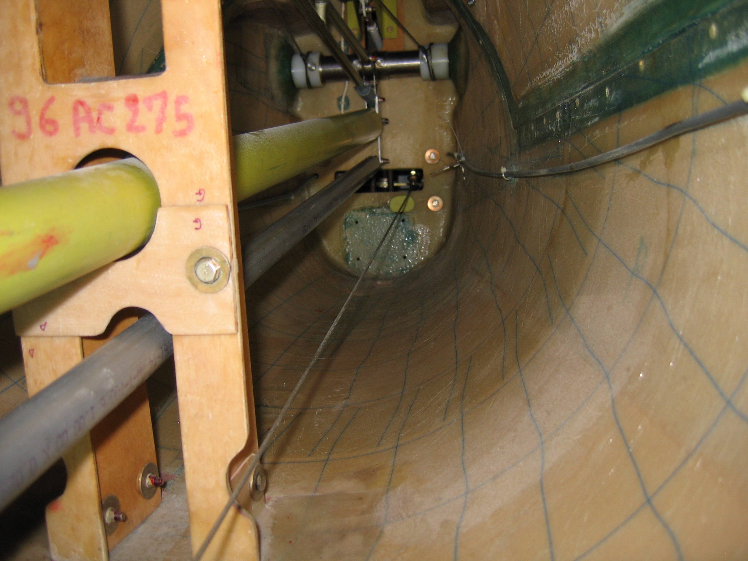

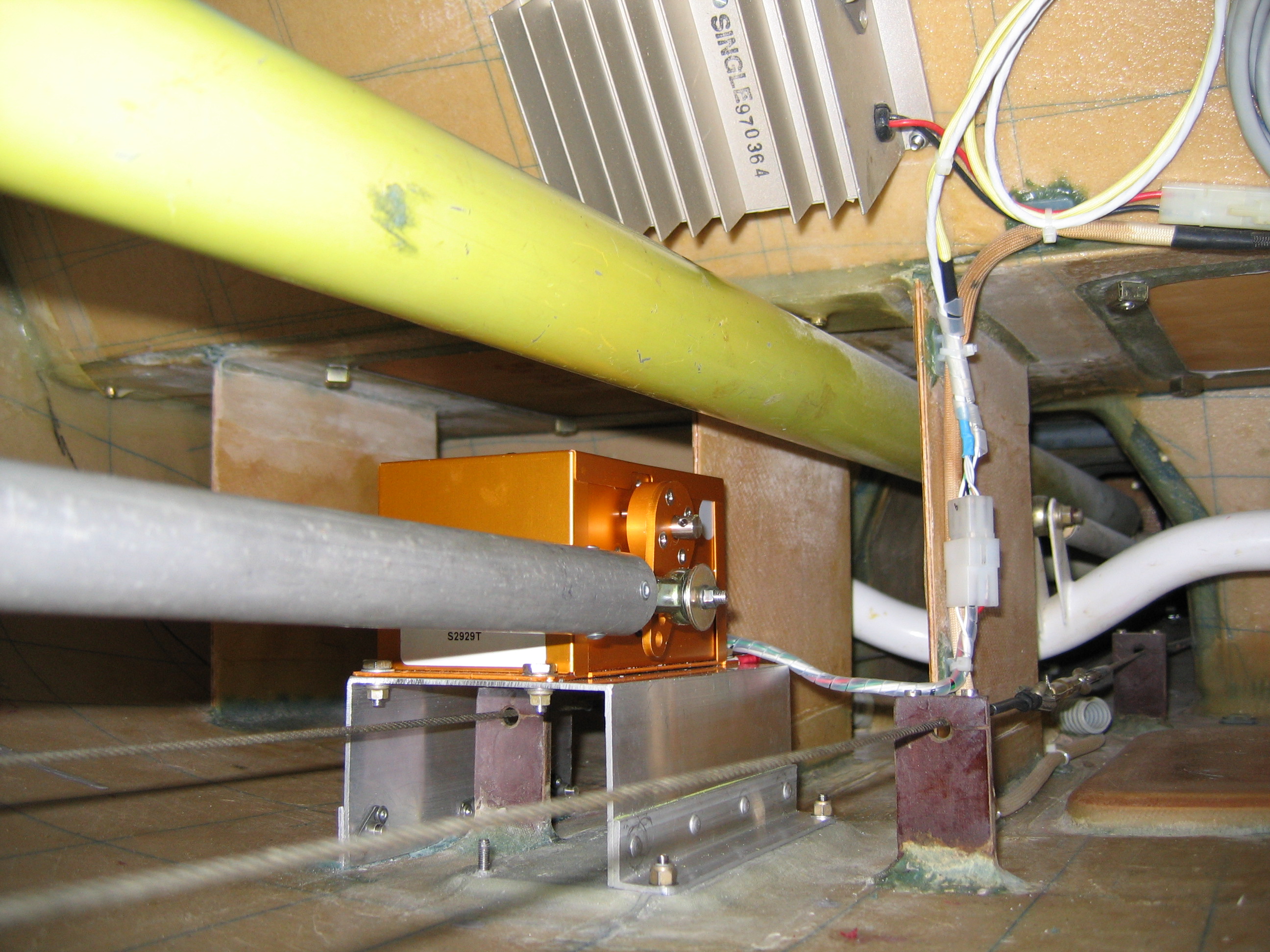

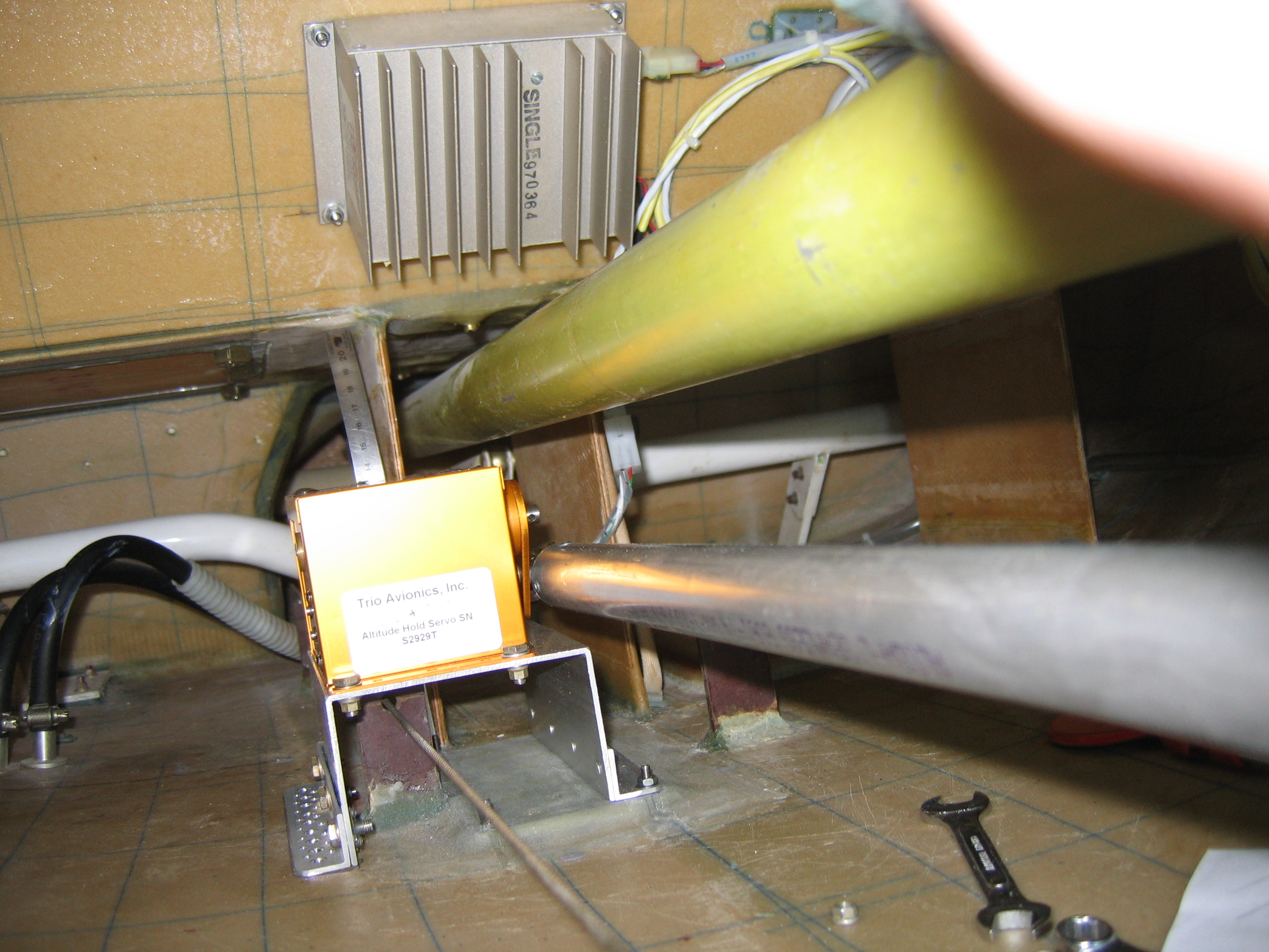

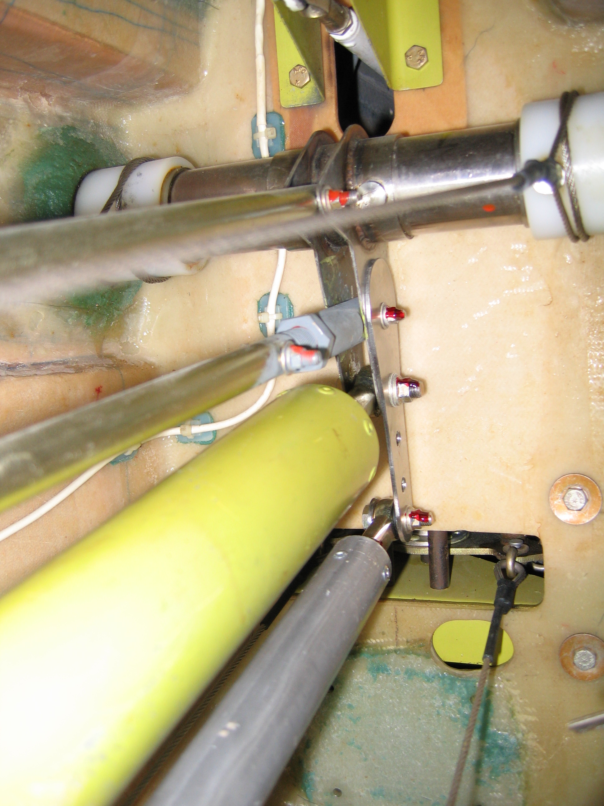

Hello,
Look at the solution I adopted from 330 hours and is much simpler than the proposed mod.
Alain CHABERT

Alain
thank you.  Very nice.
How do did you install the plate on the tail control mechanism...must have been rather difficult.
I am 1.95 and I dont see myself getting into the back of the aircraft to install the plate!
I was thinking of a similar place for the servo but with a bracket on the torque tube instead of the plate and control long rod you used.  However I wonder about the integrity of the torque tube as it seems a little thin.
I think that I will have a look at the feasibility of installing something like your system.

Alan,
Nice clean job.
I prefer not to run a thin wall one inch tube that far without an idler in the center. However, the pitch system only needs a couple of pounds of pressure when out of trim, and when the stab is trimmed neutral, very little pressure is necessary to move the stab. We design our systems for the worse case scenario, that is, full trim up the the max torque of the trim motor and the bending moment of the thin wall tubing has to be capable of taking the load plus a rather large safety factor (since it is a control system) without bending or flexing. If the trim tube should bend, it can jamb the flight control.
I prefer to put the trim motor where you did, but make a 3/2 ratio arm to drive the tube via a tube clamp.
However, to keep a short drive tube, I would recommend installing the new light weight servos behind the mass balance post using a two inch extension from the torque tube arm (there are two holes there anyway to mount .016 steel arms to). Use a 1/2 inch with .049 wall for the drive tube (like the aileron tubes). The length of the tube should be about 2 feet.

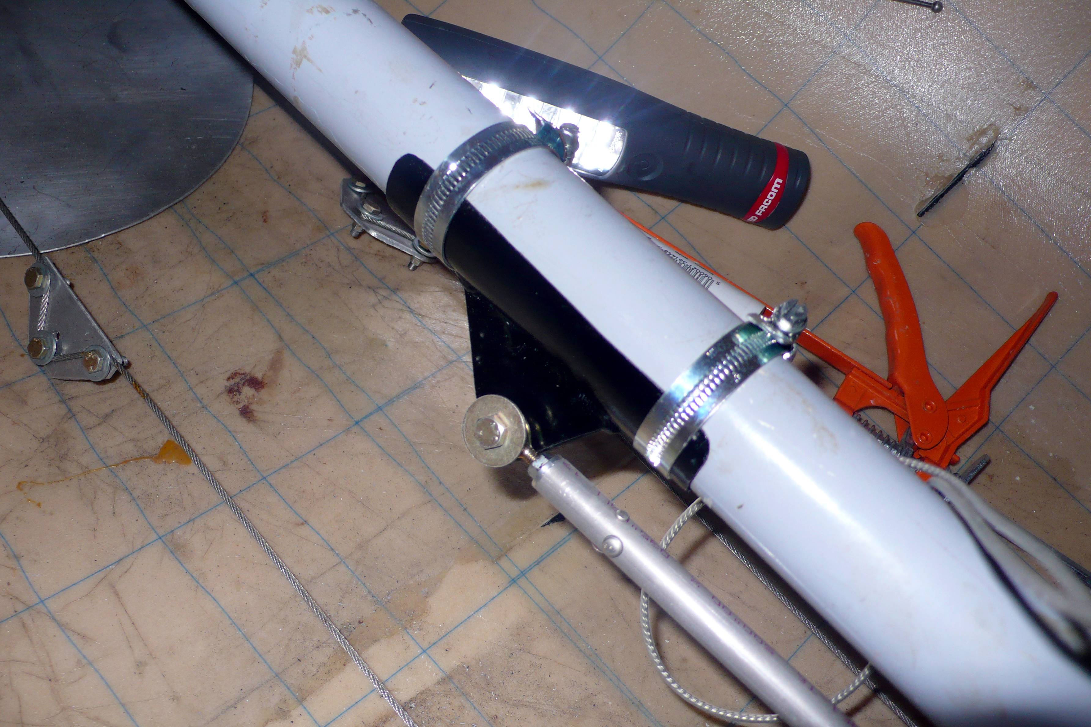

Does this mean that you put a clamp on the main torque tube?
Will

Yep.  Bob Berube first showed me and it is simple.  I use 2 in tube cut in half with a drove lug or post welded on for MW-4 attached.  Put 3/32 silicone cowl seal in the tube and clamp it on.  I prefer this if there is no access in the aft end.
Bud

Bud, Will, I have attached a couple of drawings and a picture of the UK mod application for the scheme that Bud described FYI
Nigel

Nigel
perfect thanks.
Thank makes life a lot easier that than changing the cross ways control tube.
Do you see any reason why the bracket would have to be steel...for example could it be composite provided that it was sufficiently strong/well made?
Is there a similar option for the aileron servo - ie one that doesn't require the bracket on the torque tube?  Perhaps attached to the base of the joystick.

Hello,
Alain CHABERT

I can see no reason why a composite bracket could not work provided it was well made. I would suggest two "question mark" (?) shaped mouldings back to back to ensure that the laminates are continuous (i.e. don't bond a flat piece onto a curved piece). My first choice though, would be tig welded steel.
With regards to aileron servo, I did fabricate a 2024 alloy bracket which was bonded and countersunk-screwed into the flat back-face of the P1 control yoke (prior to assembly of the control system) and driven by the sevo sitting under the seat via short pushrod in front of the seat.
If you have already constructed the under-seat controls, then your options are limited.
Nigel
Bud

Alan,
Nice clean job.
