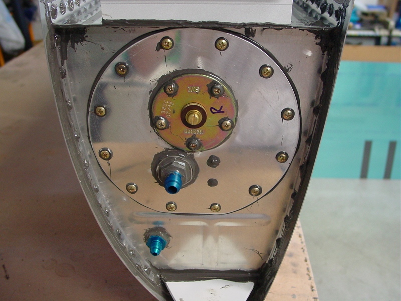

If you happen to have any pictures of the places or parts which you
repaired I would be grateful if you could send one or two.
George

PostPosted: Mon Apr 13, 2015 4:24 am    Post subject: Fuel Leak Once More from Starboard Tank Reply with quote
George, I couldn't find any pictures of my own fuel tank problem, but this picture that I got off the net (I hope that is not a problem )illustrates the areas that I had trouble with. The gasket under the access cover leaked (probably because I installed it dry originally) and then the other area which is at the bottom of the picture is where I had the most problem. This is where the bracket to tie the tank to the fuse is installed. i was able to remove the access cover (after removing the tank from the wing) and as Charlie said clean it, scotchbrite it, clean it some more and reproseal. This after you've pressure tested the tank to verify where the leak is. Make sure that you seal the screws that fasten the access cover on the tank as those have been known to leak if not sealed.
Cheers!

jay.pearlman(at)yahoo.com
PostPosted: Mon Apr 13, 2015 11:16 am    Post subject: Fuel Leak Once More from Starboard Tank Reply with quote
George,
The newer instructions for the RV say that the cover with the fuel gauge should not have a gasket, but should be pro sealed. The pro sealed cover should bee able to be removed with a heat gun if necessary. I suggest that you look on the vans air force forum. There are many discussions for rising leaks and many are from experience. VAF Forums
VAF ForumsDoug Reeves' VAF Forums - Where fans of Van's Aircraft kitplanes hang out on the web.
View on www.vansairforce.com
Preview by Yahoo

PostPosted: Mon Apr 13, 2015 11:39 am    Post subject: Fuel Leak Once More from Starboard Tank Reply with quote
Good call! Mine was done a number of years ago and I hadn’t paid too much attention to the forums on that front. Thanks for the info for my own gratification.

George,
The newer instructions for the RV say that the cover with the fuel gauge should not have a gasket, but should be pro sealed. The pro sealed cover should bee able to be removed with a heat gun if necessary. I suggest that you look on the vans air force forum. There are many discussions for rising leaks and many are from experience. VAF Forums<http://www.vansairforce.com/community/index.php>
[image]<http://www.vansairforce.com/community/index.php>
