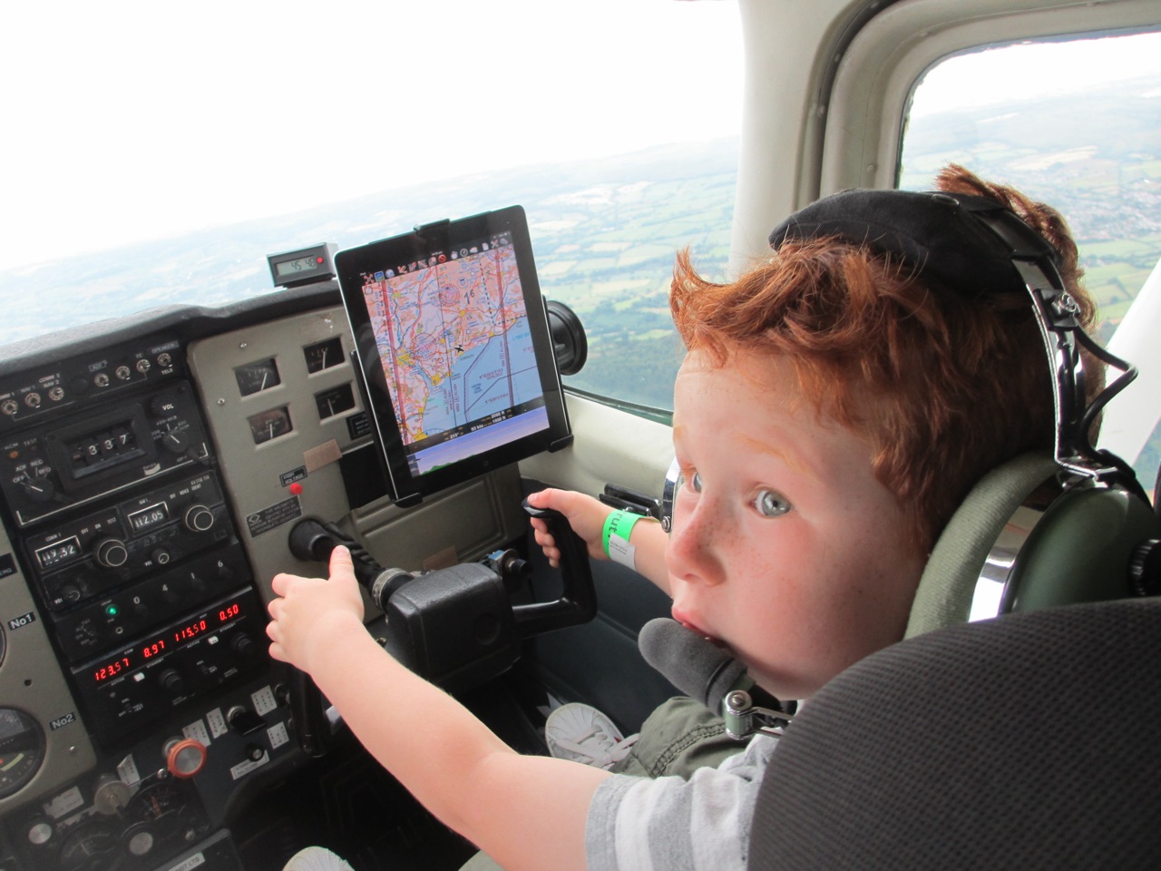

Here's how I use my iPad: oh yes: that's my four year old grandson co-pilot
John

Great photo! That’s the way to get them started!
Marv
