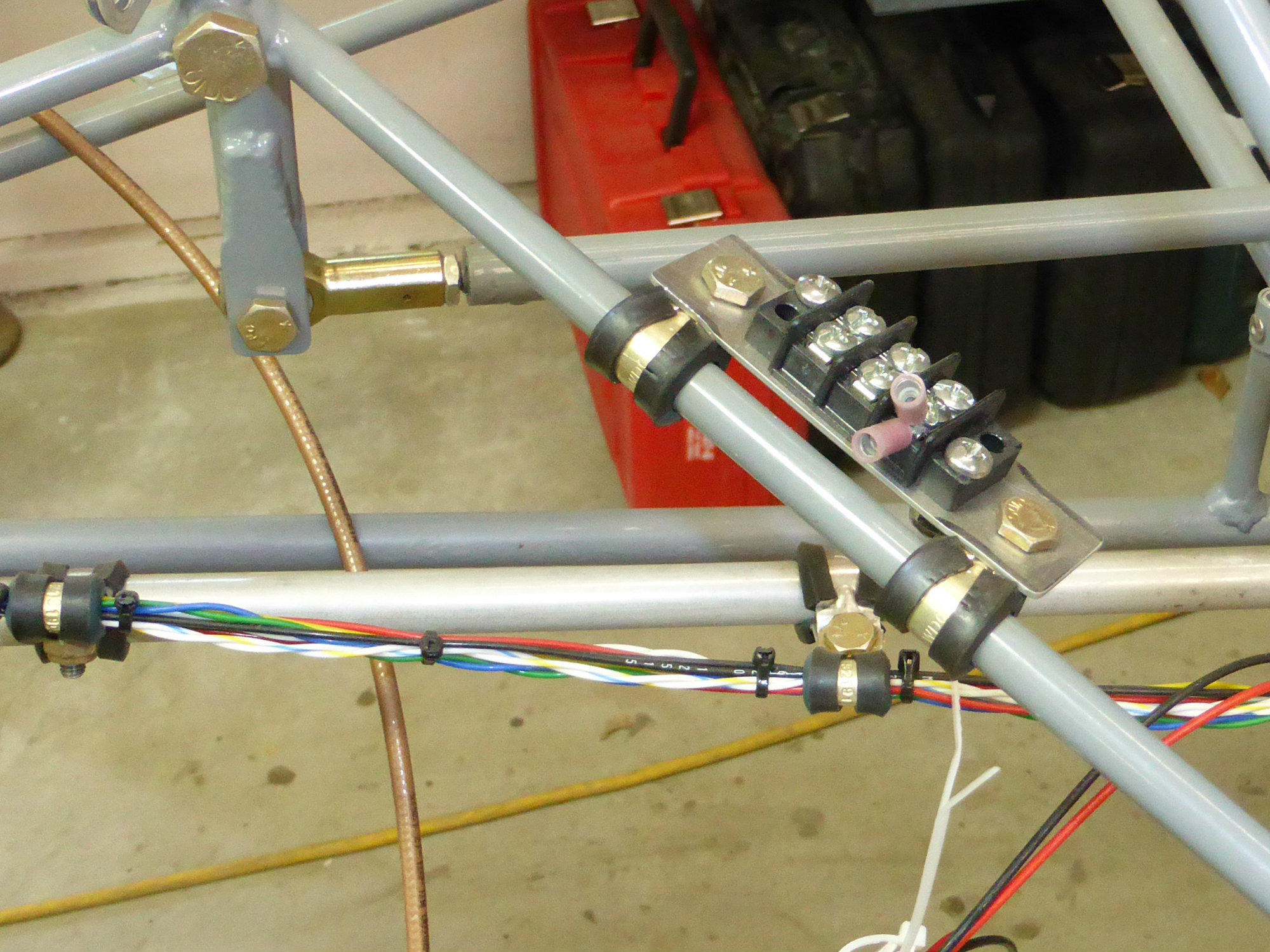

I have two beacons, each beacon has a positive, negative and
synchronization wire. I need to connect the wires from each beacon and
then send them forward. I have chosen to accomplish this with a
terminal strip.
I have noticed that the terminal strips do use star washers. Should I
use a star washer atop my ring terminals? Or maybe I should use thread
locker on the terminal strip screw?
Also, is it okay to stack two ring terminals on one side of the
terminal strip (as shown in the attached photo)?
Thanks.

Unless the wires will be taken apart frequently or need to be exposed for testing, I prefer to make a permanent splice. Terminal strips could be a trouble spot due to loose screws or corrosion. If a terminal strip is used, an internal tooth star washer between the ring terminals and screw head is a good idea. Temporary thread locker could also be used. When I install two ring terminals under one screw, I orientate them back to back so that a ring terminal does not have to be bent. A thin film of grease will help prevent corrosion. Grease does not hinder conduction because the screw pressure forces the grease out. Thus there is still metal to metal contact. Wires should be supported close to the ring terminals to prevent any relative motion due to vibration. Your installation looks neat with the cushion clamps.

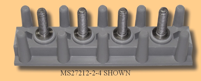

As a general rule, new designs will minimize the use of threaded fasteners . . . particularly screws into soft threads (Yeah, circuit breakers do that . . . you just gotta live with some things!). Those barrier strips are brass screws into brass nuts formed out of the two-barrel, hollow rivet that makes up the conductor between screws.
The preferred terminal strip is illustrated below. CAPTIVE studs designed to take a stack of terminals and press them together in gas-tight harmony with the universe.
[img]cid:.0[/img][/b]
These things are not cheap. However, you can make your own from a block of phenolic, Delrin or similar structural insulator. Press hex headed studs into undersized, counterbores and pot the back side with epoxy. Crank a nut down on TOP of the block to capture the stud.
Now you can stack as many terminals on the studs as you like while maintaining gas-tight integrity between the stack of terminals. A metal locking nut on a quality steel screw will squish things together with a great deal more robustness than those brass screws into internally threaded, brass sleeves.

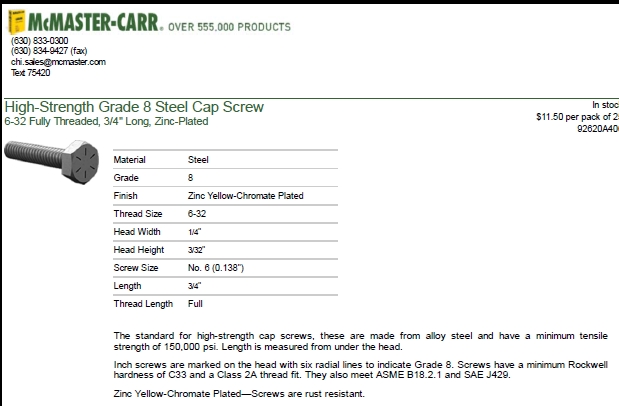

A hex headed screw is easy to 'captivate' in your
base material. I.e. pressing a screw like this
[img]cid:7.1.0.9.0.20150620112938.073a0d68(at)aeroelectric.com.1[/img]
to bottom out in a 1/4" counterbore will force the
hex-points into a good grip on the base. Experiment
a bit . . . I might have used a 9/32" bore . . . it's
been awhile. You don't want to break the base with
"too much grip."
McMaster-Carr can offer you grade-8, hex screws
but you need to buy a pkg of 25. Any good hardware store's
specialty screws bins may offer smaller lots of similar
screws. Use a washer and nut on the top side and
some epoxy fill underneath to finish installing
the stud.

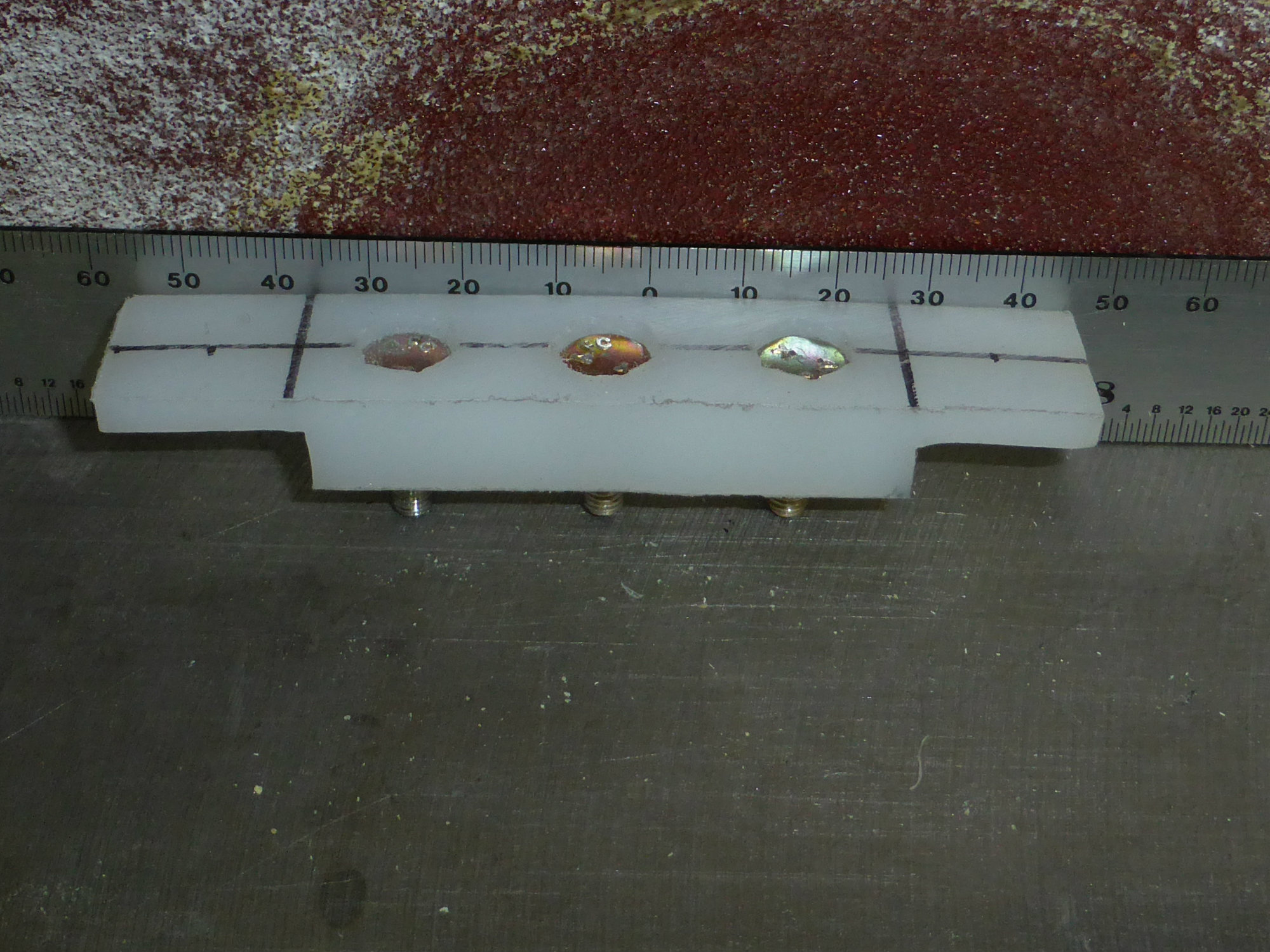

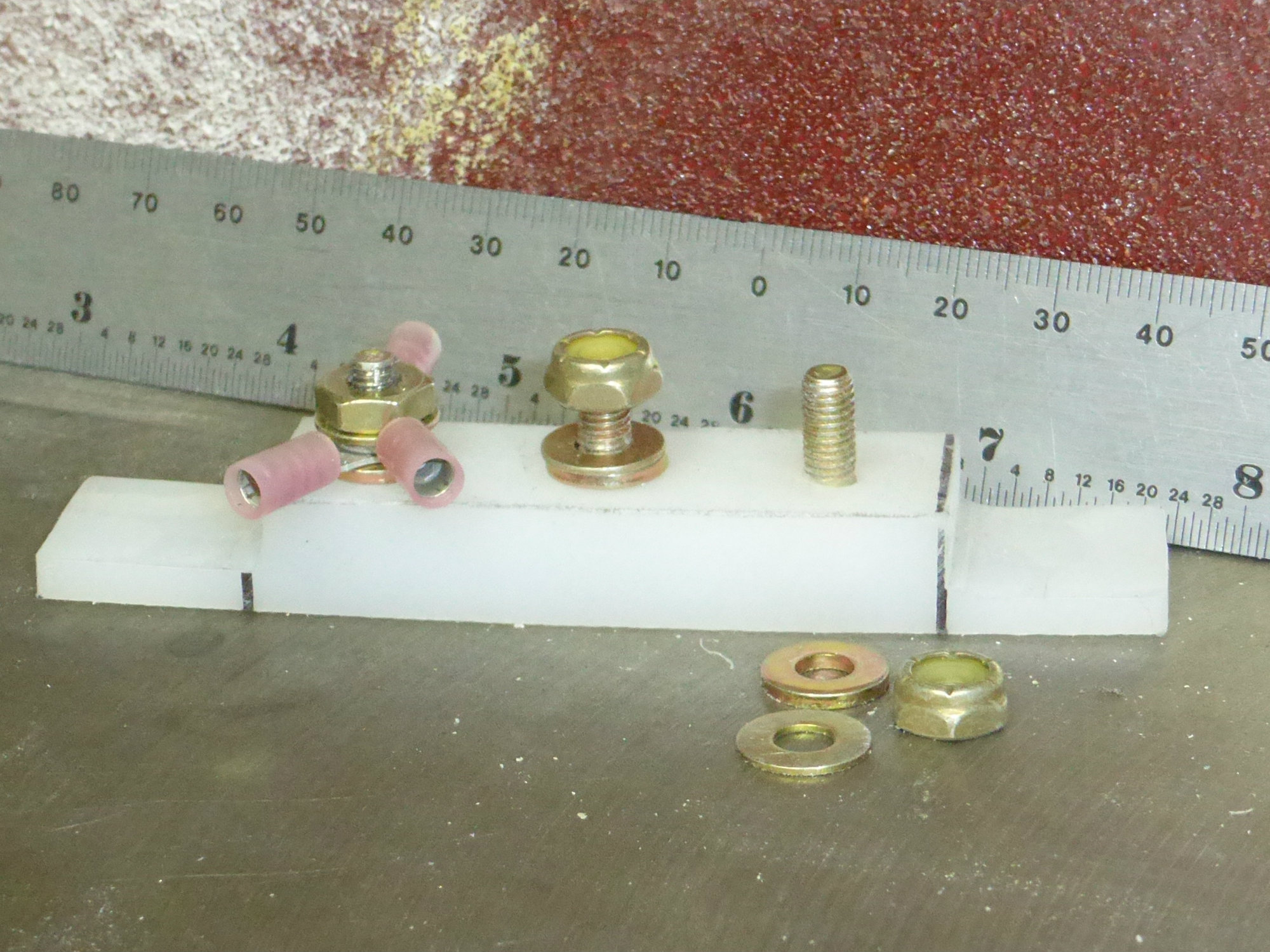

UHMW + standard AN3 hardware seems to have worked pretty well. Pics attached.

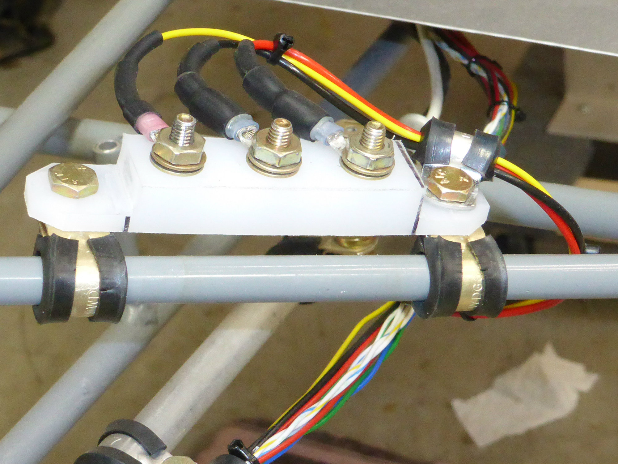

Pic showing temp/partial installation:

You done good my friend . . . just remember
that as you add wires to any post, there
should be no intervening hardware between
terminals . . . i.e. the terminal strip
hardware is there to separate, support and
put the super-mash on the stack of terminals
. . . no hardware should be tasked with carrying
electrons.
In your particular case, the currents are low;
failure to observe that process goal is not fraught
with risk.

I do not see a nut under the ring terminals. Is there one? Ring terminals need to be squashed between two nuts, not between a nut and plastic because plastic will flow over time, causing the connection to loosen.

There's a washer under the terminals.

What Joe is referencing is the fact that
'gas tightness' in the interface between
current carrying parts depends on the pressure
established and maintained by either crimping
or, in this case, squeezing between two very
stable forces in the clamping mechanism. Force
from a nut driven down onto the terminals is
reacted by a plastic surface under the stack.
The plastic is not stable under continuous
pressure and will relieve to some degree over
time and temperature cycles.
In your particular application, the currents
and duty-cycles involved do not imposed large
stresses on those interfaces . . . and you'll
be find with what you have. But were you crafting
say, a distribution point for fat wires carrying
tens of amps continuously and perhaps hundreds
of amps cranking . . . the need to bring those
terminals together with TWO nuts is greater.
You can see that the base of these studs is part
of the metal that makes up the stud. Terminals
stacked on these studs can be brought up to
and held at gas-tight pressures without adding
the nut under it. With the DIY terminal block
the bottom nut takes on this duty. You're okay
as is for THIS application but folks reading this
thread later need to be aware of the physics.

Might have to re-make it. I have doubts that the UHMW will "flow" enough (with 15 inch-pounds of torque) to loosen connections. Anybody here qualified to interpreting attached document regarding this question?

I wouldn't loose any sleep over it. The
argument goes more to support standard practices
based on the full spectrum of stresses.
It is not terribly relevant to your application.
