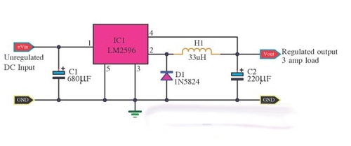

PostPosted: Sat Apr 11, 2015 8:26 am    Post subject: V-Charger Reply with quote
Virtually ALL 12 to USB charger products are
crafted with some version of the switch-mode,
buck converter design . . .
[img]cid:.0[/img]
In recent years, the capability and sophistication
of various step-down chargers has mushroomed. You see
bins of cigar cigar lighter adapters at the
cash register of convenience stores . . . priced
from 4 to 10 dollars each.
[img]http://i.ebayimg.com/00/s/NjAwWDYwMA==/z/lX0AAOSwNSxVJbNi/.JPG[/img]

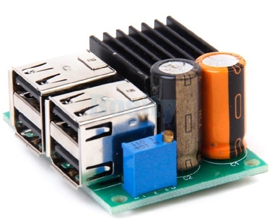

You can buy guts-only boards for this and similar
products for as little as 50 cents per working item
on ebay. Here's a 4-port, 5 Amp adjustable model you can
buy for less than $5 mailed to your door.
[img]cid:.1[/img]
The the technology to make these capable critters for
so little money is gargantuan automated production
volumes and minimizing parts count. These convertera
all operated at 100 KHz up . . . some as high as one
Mhz. Problem is that the waveforms are anything but
sine-wave and exceedingly rich in harmonics. They
are miniature rogue transmitters. The minimalist
parts count philosophy encourages designers to
discount if not totally ignore any potential for
interference to other systems. FCC Part 15 rules
allow extra-ordinarily antagonistic emissions with
the admonition, "Users must discontinue use of
this device if it interferes with other products
or systems".
The EASY work around is to craft a 14 to 5 volt
step down regulator with linear components. Virtually
noise free but the have to toss off a lot of heat.
They are limited to 33% efficiency by design.

12 to 5 volt converters at Jameco.com
SD-15A-5 $13
SKM15A-05 $25
SKA20A-05 $27
SD-25A-5 $20
Joe Gores
jan_de_jong(at)casema.nl
PostPosted: Mon Apr 13, 2015 2:10 pm    Post subject: V-Charger Reply with quote
Thank you, Joe.
Look good, especially the high efficiency SK* items, but they have a
minimum output current of several hundred mA.
I would like to know what happens to the output voltage when the output
current drops below the minimums in the datasheets (device being charged
could be off).
Jan de Jong
SD-15A-5 $13
SKM15A-05 $25
SKA20A-05 $27
SD-25A-5 $20
Joe Gores
user9253
Joined: 28 Mar 2008
Posts: 1978
Location: Riley TWP Michigan
PostPosted: Mon Apr 13, 2015 5:14 pm    Post subject: Re: V-Charger Reply with quote
http://www.jameco.com/Jameco/Products/ProdDS/2166629.pdf
I wonder what the output would be if the load were less than 300ma?
Would it refuse to turn on unless it sees a certain resistance?
Or would it turn on but the voltage would be unstable?
Joe
