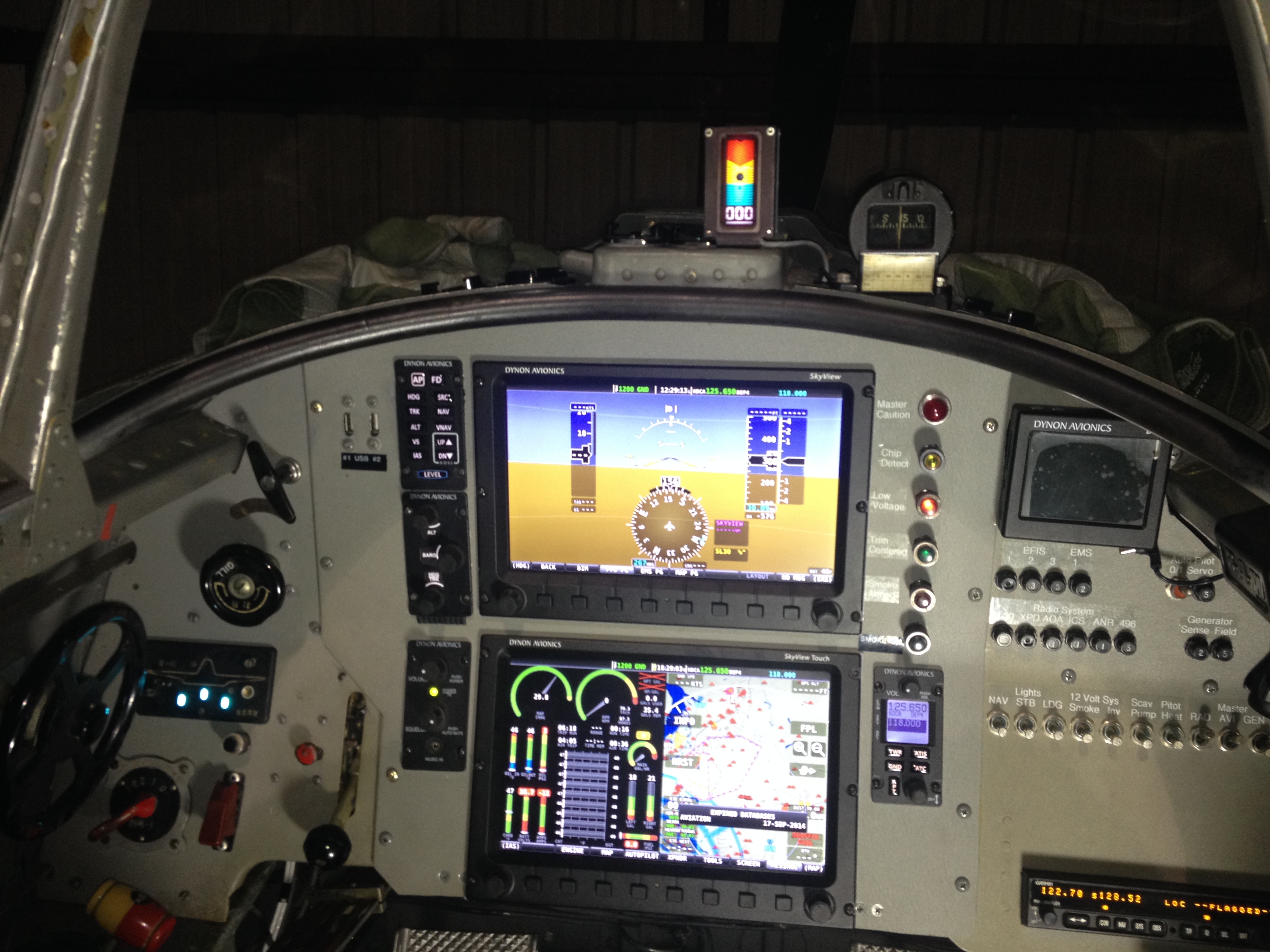

I know you said you don’t want a glass cockpit, but while there, check out the Dynon booth.  At least check out the D2 as a backup for ~$1,000  ; http://dynonavionics.com/docs/PocketPanel.html
Here is  quick picture of my pit…  Note: it’s in the hangar so synthetic vision isn’t on.
Bear

I took out ALL my Chinese wiring and put in  three 10” Dynon EFIS panels (2 in front pit, 1 in back), 2 axis autopilot, dual adhars, etc. and got the log book entry for IFR.  I’ve flown it IFR (NO LOW IFR) some and really recommend the auto pilot   I’ve flown dozens of approaches (real/hood) with it and it is a good plane but I still would recommend the AP.
Check out the Dynon D2 backup instrument (attitude, alitimeter, heading, etc.) gps based for not a lot of cash.

I could see that in the 50! Nice panel DeBear!
