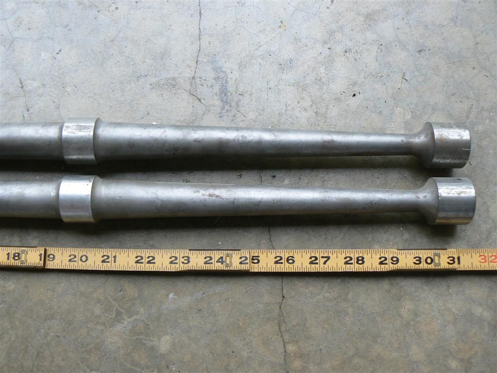

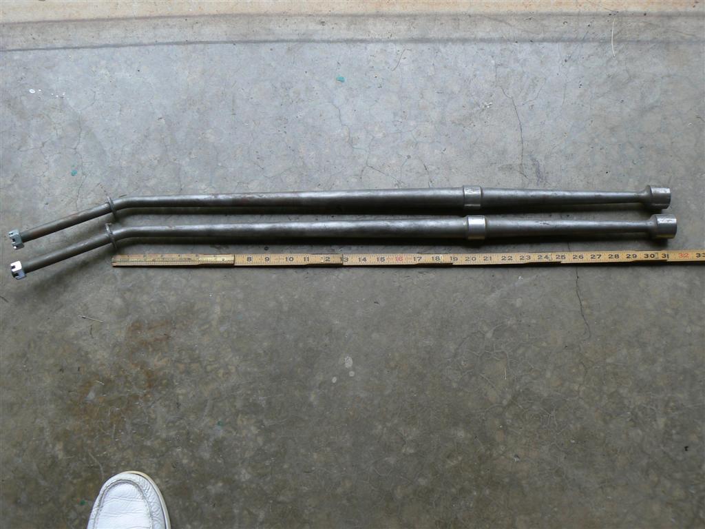

PostPosted: Thu Apr 09, 2015 3:45 am    Post subject: Re: MK 111 rebuild Reply with quote
pipercolt wrote:
I have removed the single pedal cable brakes and want to install the Matco hydraulic brakes. Is there any drawings on how and where to install them. I also bought a set of steel gear legs but they don't look like they will fit. The aluminum ones are same size all the way up inside the tubing on the cage but the steel ones have 2 collars around them and are considerably smaller in diameter where they exit the cage. Are they not for a MK 111?
Bob
If they look like this, then yes, they are for a MKIII. I am using them now.
 Filesize:  101.79 KB
 Viewed:  24109 Time(s)
 Filesize:  112.85 KB
Richard Pike
Kolb MKIII N420P (420ldPoops)
Kingsport, TN 3TN0

Thanks for the replies. Yes Dennis, those are the legs that I have.
Bob

I also have the tapered spring steel landing gear that Richard posted photos of. Old Kolb developed these gear legs. When Old Kolb built them they welded a tubular extension on the nub at the 31 inch (from Richard's second photo) part of the gear legs. This extension carried the landing load further up into gear socket in the fuselage cage.
When I installed these gear legs on my MKIIIC I slipped a 4130 steel tube over the gear legs from the 21 inch measure to app 36 inch measure. The tube is slightly smaller OD than the gear socket ID. I had to grind the nub at the 31 inch measure down a bit to fit in the reinforcing tube. I would have welded on a extension on like Old Kolb did but was afraid of changing the tempering of the gear legs.
The gear legs are great, very durable with plenty of travel and spring. They are shorter than the newer tubular gear legs but work well for me. You do have to be careful because the spring in the gear will bounce you back into the air on a bad landing.

I've never heard anyone on this list who has those style legs complain about them and they seem to be super durable.
Having started with the original straight aluminum legs and  switched to the taller bent steel tube legs, I much prefer the look of the taller steel legs.

If the bend wasn't too severe you should be able to straighten them once or twice, past that, I'd scrap them.
Dennis "Skid" RoweMk3, Rotax 670,
Leechburg, PA
On Apr 9, 2015, at 4:53 PM, kinne russ <russk50(at)gmail.com (russk50(at)gmail.com)> wrote:
[quote]My alum ones are still on the a/c but I had to straighten one . Do you know if this ‘softens’ them ?
On Apr 9, 2015, at 4:34 PM, Dennis Rowe <rowedenny(at)windstream.net (rowedenny(at)windstream.net)> wrote:
I'd sell you my aluminum ones but I figured they are good spares. Lol!Dennis "Skid" RoweMk3, Rotax 670,
Leechburg, PA
On Apr 9, 2015, at 1:31 PM, kinne russ <russk50(at)gmail.com (russk50(at)gmail.com)> wrote:
Dennis - here’s a small complaint; witht the taller legs my Xtra wont fit into the trailer/hangar!Russ
On Apr 9, 2015, at 1:08 PM, Dennis Rowe <rowedenny(at)windstream.net (rowedenny(at)windstream.net)> wrote:
Do not archiveDennis "Skid" RoweMk3, Rotax 670,
Leechburg, PA
On Apr 9, 2015, at 11:17 AM, Rick Neilsen <neilsenrm(at)gmail.com (neilsenrm(at)gmail.com)> wrote:
Rick Neilsen
Redrive VW Powered MKIIIC
On Thu, Apr 9, 2015 at 7:45 AM, Richard Pike <thegreybaron(at)charter.net (thegreybaron(at)charter.net)> wrote:

pipercolt
Joined: 08 Jan 2012
Posts: 46
Location: Randolph New York
PostPosted: Thu Apr 09, 2015 3:42 pm    Post subject: Re: MK 111 rebuild Reply with quote
Neil
I wonder what the reason was that Old kolb welded on the extension. Thanks to all that have responded. This is a great site.
Bob
PostPosted: Thu Apr 09, 2015 4:33 pm    Post subject: MK 111 rebuild Reply with quote
Summer 1988, after flying over Niagara Falls the first time in my Kolb
Firestar, I had an engine failure and forced landing over the river between
Buffalo and Grand Island, NY, in the middle of the Niagara River. Got real
busy on short, short final and stalled the Firestar ripping out the gear leg
socket and shearing a socket in midsection. Up until this time the
instructions called for running the gear leg only halfway into the socket.
This put the load at the weakest point where the socket was drilled for
securing the leg. Winter 1988, Brother Jim and I completely rebuilt the
Firestar fuselage. We decided at this time to run the 4130 gear legs (our
design) all the way into the socket until it bottomed out at the
intersection, spreading the load throughout the socket. Never sheared
another one after that.
The extension was an improvement over the old system of insertion only
halfway in.
Homer Kolb used to tell me I was his best test bed. If it could be broken,
I'd probably do just that.
