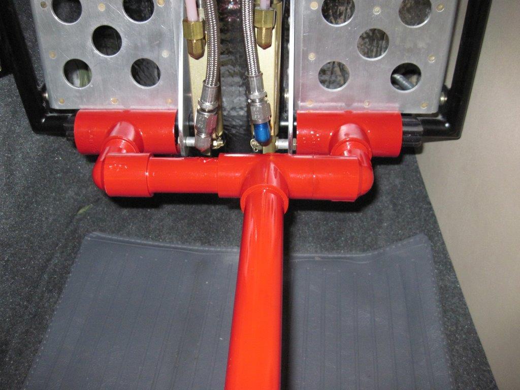

PostPosted: Wed Apr 08, 2015 6:07 am    Post subject: Re: Gust Locks Reply with quote

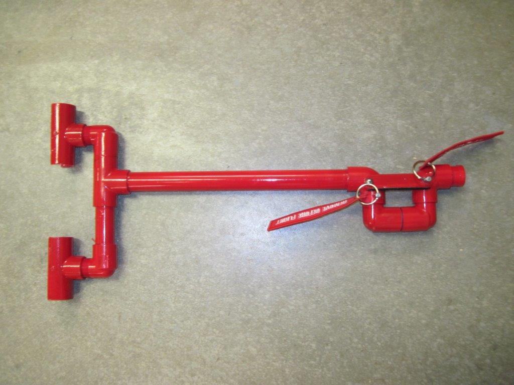

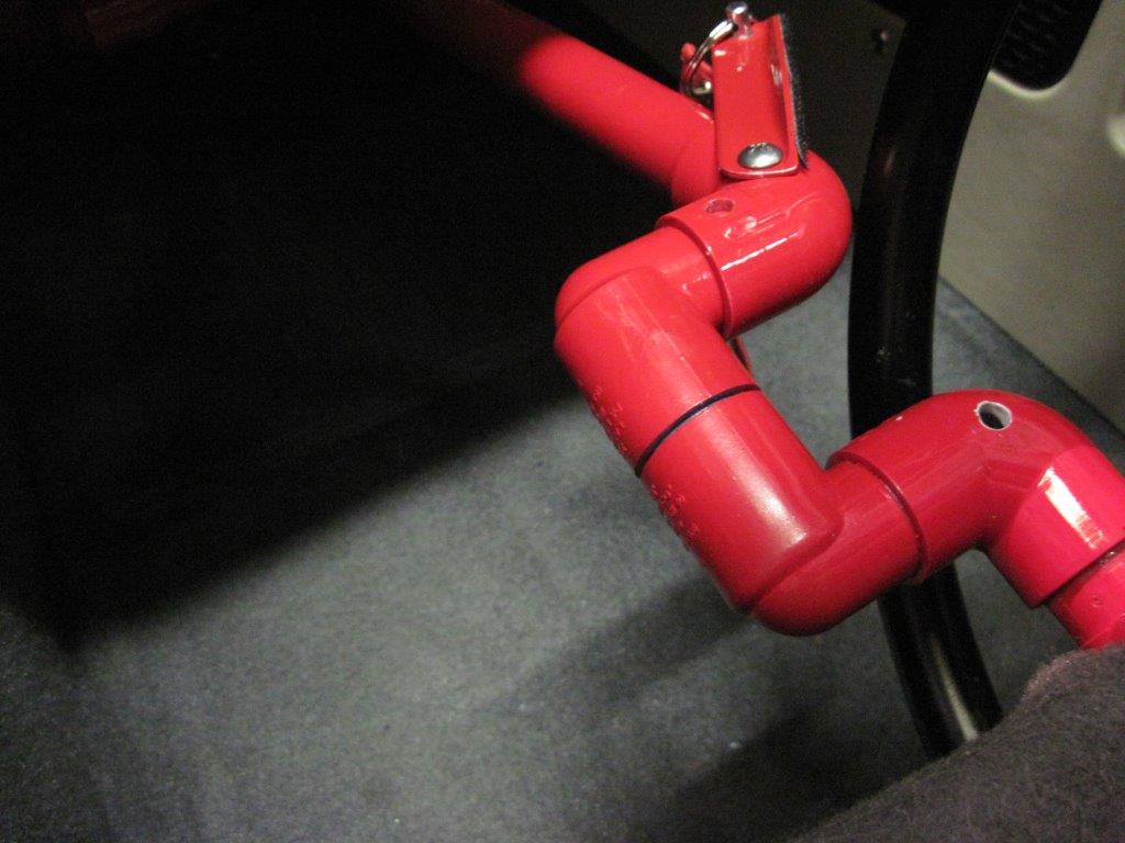

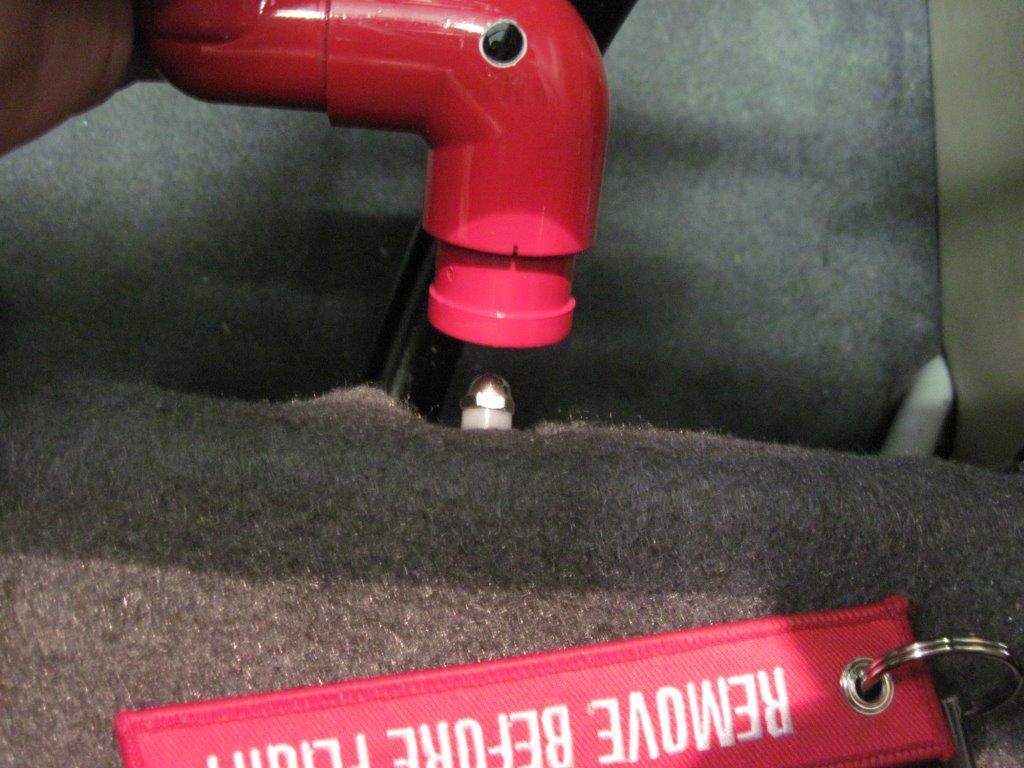

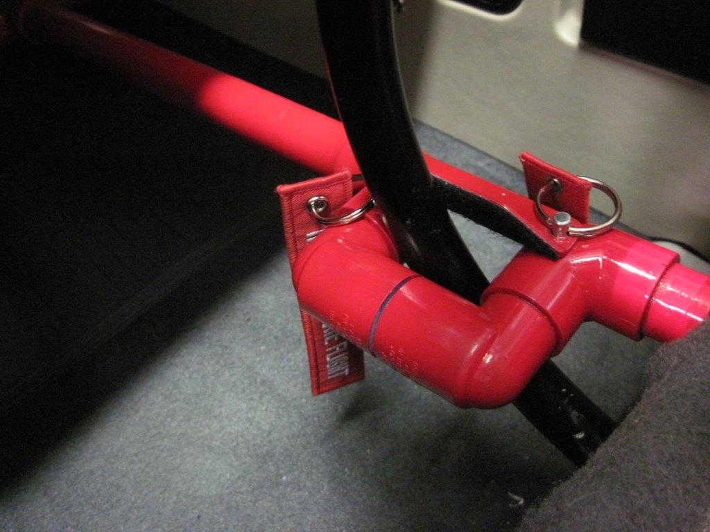

Make your own. Less than $20 from Lowes. I have been using this for almost three years.

Bill

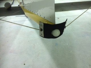

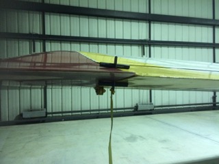

PostPosted: Thu Apr 09, 2015 2:44 am    Post subject: Gust Locks Reply with quote

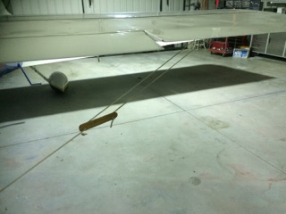

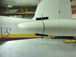

Here are pictures of my home made gust locks. They pack into a 4”X6” bag.
RobK
[img]cid:A1B5402F-8C7C-4D7E-9853-753E8141A680(at)lan[/img][img]cid:7E5B3900-8E91-4093-B57F-01269070DFFF(at)lan[/img][img]cid:12F03670-5213-4AFE-B15A-C98167EB0CA2(at)lan[/img][img]cid:A03B230A-82E9-447D-8102-3D4860A7AFD1(at)lan[/img][quote]Les;I miss some e-mails for some reason so I am only seeing your response and not who Alan is, however I have a antisplat gust lock that does require me to unzip the control stick cover and also requires the wires be routed on the inside of the stick, as the retainer is bolted to control stick.If you don’t mind unzipping the cover and your wires are on the inside, I highly recommend it. http://antisplataero.com/RV-10_Ultimate_Gust_Lock.htmlanother option, a home brew is- http://www.vansairforce.com/community/showthread.php?t=120730&highlight=gust+lock--
