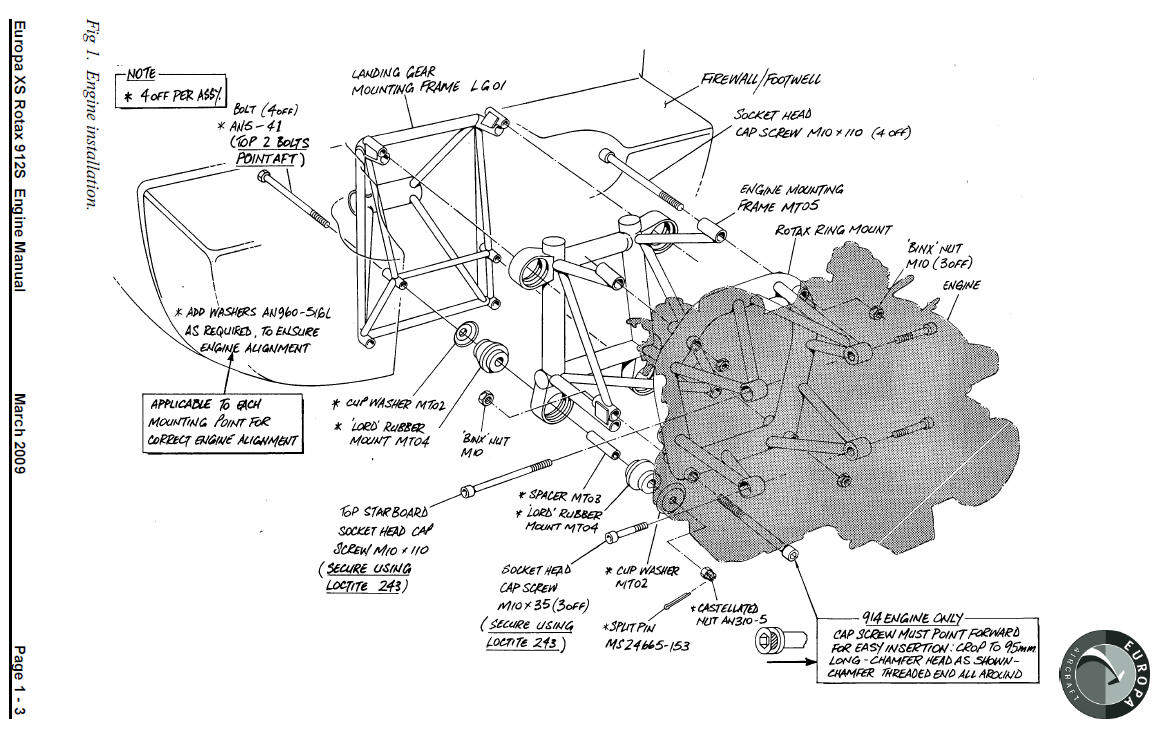

Martin,
There should be no structural reason why the bolt needs to be aligned in a particular direction, as they are fore-aft the 'normal' convention (for vertical bolts) does not apply.
Reading the manual (XS 912 installation) it states that the AN5-41 should be mounted lower two pointing forward and upper two pointing aft. This applies to the MT05 mount.
But for the Classic with the MT01 mount the orientation shows the lower bolts as pointing aft.
John
