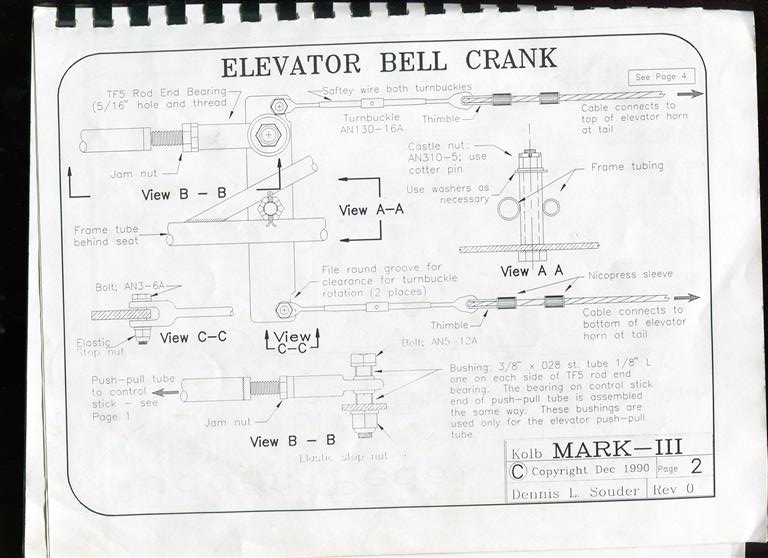

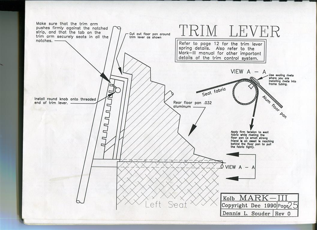

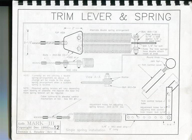

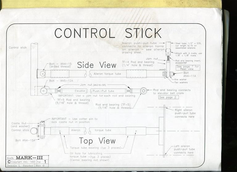

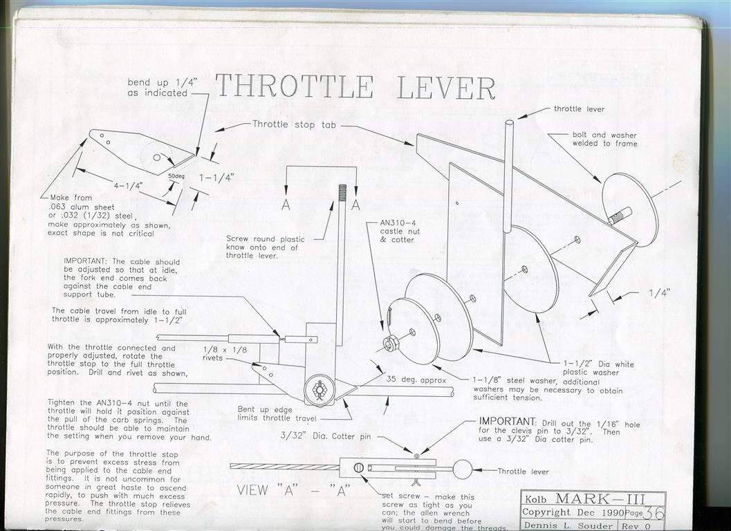

I bought a wrecked MK 111 classic that I am rebuilding. I have the original builders manual but it doesn't contain any info about installing and hooking up the controls that are between the seats, like the elevator cables, throttle, and trim. Is there a separate manual for this kind of stuff?

Yep. I ought to scan it and post it online as a reference, but in the meantime, here's these:
