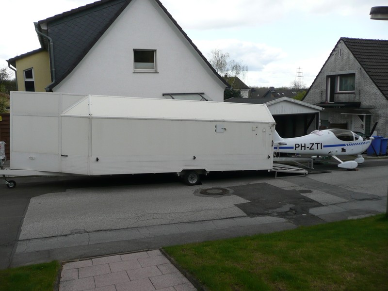

PostPosted: Wed Apr 08, 2015 1:41 am    Post subject: Re: 912S Starter on a 914 Reply with quote
Bob,
forward this to Ivor - end of hangar problems. You know best, that the Europa is well suitable for rigging.
