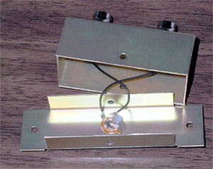

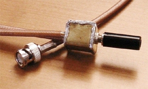

What good man Jim has described in his article
is a clone (along with evaluation of performance)
of the Icom hand-held antenna jack and SWITCH
that we discussed earlier in this thread and
at some length years ago.
[img]cid:.0[/img]
^^^^ Icom Product ^^^^
[img]cid:.1[/img]
^^^^ AEC DIY project ^^^^
