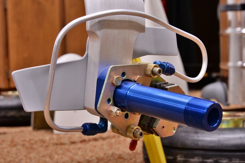

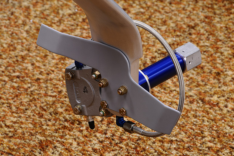

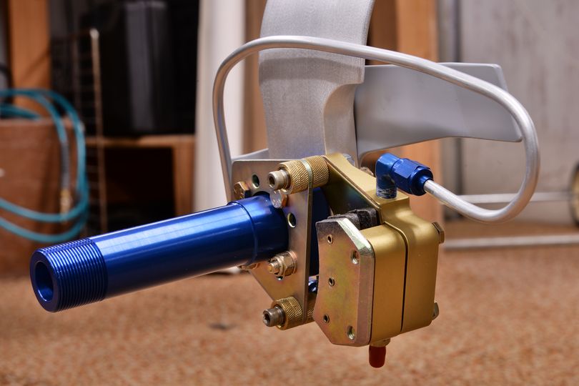

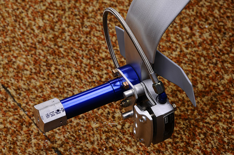

My RV-8 Version 1.0 came with Cleveland wheels and brakes and they worked fine. RV-8 Version 2.0 came with Matco wheels and brakes. While I haven't actually flown with the Matco's yet, I have to say they seem better built and more "manly". Time will tell.
Attached are a pair of pictures from my Cleveland installation and another pair of pictures from my Matco installation for comparison.
