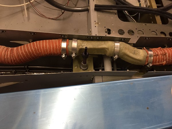

The second is to construct a fiberglass duct to route around the problem
areas. Is the hot air from the heater valve hot enough to cause
problems with a duct constructed of glass and west epoxy?

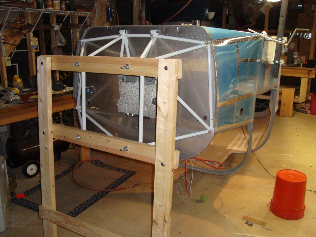

PostPosted: Tue Mar 24, 2015 11:54 am    Post subject: Rear Heat SCAT Tube Routing Reply with quote
Larry,
I looked for a photo but only found one when the fuselage was upside down
(attached). So if you can visualize, the flap that is hanging down would
hang over the top of the boxes and scat hoses when upright. You can see the
round notches cut to lay over the scat hoses. The result is the dumped hot
air from the cabin heat boxes is directed down toward the cowl exhaust area.
Carl

PostPosted: Tue Mar 24, 2015 1:56 pm    Post subject: Rear Heat SCAT Tube Routing Reply with quote
My first 2”-1.5” scat reducer was made of fiberglass.  The first time I turned on the rear heat it did off gas.  I replaced it with one made of aluminum.

Attached is a photo of my SCAT tube solution. I made a fiberglass tube
to go around the Andair fuel valve stem. The tube is held in place by 2
pipe clamps that are riveted to the tunnel.
Larry
