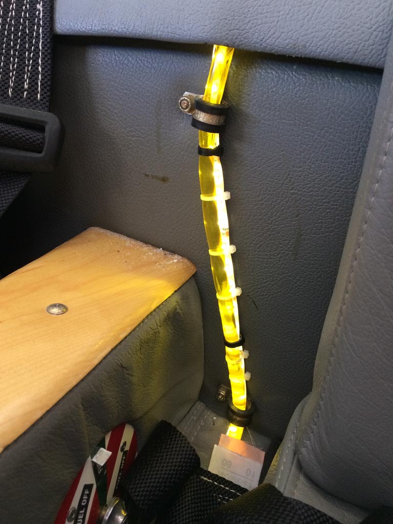

I had the original sight gage installed per Europa instructions. It only tells you when the fuel “may” be getting low. For a better idea of the fuel usage, I installed the dual fuel flow option on my Grand Rapids EIS4000. When calibrated, it seems to be accurate to much better than a half pint (about 250 cc) in a tank of gas.
When I replaced my leaking tank last year I removed the original, pretty much useless, sight gage and replaced it with a sight gage that runs from the bottom of the tank, main side, up between the seats, near the pilot:
[img]cid:22EDE013-1F72-427F-95FD-AC2F99B6C059[/img]
It is also back lit with a string of 12v lEDs. The remainder of the 15 ft (5 meter) string is run around the inside of the tunnel for inside work illumination. It’s not shown in the picture but there is a switch/dimmer for the lighting. I used the ties to mark calibration points: 06 gal (at) bottom of lower P-clip; 07 gal, top of lower P-clip; 08 gal (at) first white tie; 09 gal (at) 2nd white tie, 10 gal (at) 1st black tie; 11 gal (at) white tie; 12 gal (at) white tie; 13 gal (at) white tie; 14 gal (at) white tie; 15 gal (at) 2nd black tie; 19 gal (at) top of upper P-clip; 20 gal (at) top of gage. You can see that in this picture the tank is holding 15 gal.
In the 25 hrs or so I have flown since replacing the tank, this gage has proven to be almost as accurate as the totalizer down to where the gage disappears. When the fuel disappears in the gage you are close to a mandatory switch to reserve and time to find a place to land if you are not already there.

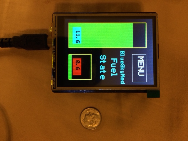

The Europa fuel measurement options are all problematic.
The original sight gauge was difficult to read and inaccurate. The sight
gauge I installed between the seats still has two very significant problems.
One: the vent for the sight tube of necessity must have some bends in the
tubing, allowing fuel to become trapped and preventing the gauge from
free venting. This occurs when line boys are over exuberant about
filling up the filler neck and flooding the vent line (which I have opening
into the top of the filler neck). Trapped fuel then causes the sight tube to
read inches low.
Two: The curious saddle bag design of the tank allows easy, yet
undetectable shifting of what fuel you may believe to be in the reserve
side into the main, potentially leaving nothing for reserve. This has happened
after some gentleman macro and even after some steep turns in the
presence of bumpy air.
The capacitive measurement systems are all non-starters where we are
fortunate to have choices in fuel (av vs. mo-gas).
The remediation I have been playing with involves two honeywell pressure
transducers at the bottom of each fuel bung feeding an Arduino with a
touch sensitive LCD screen. Not quite finished for publication, but the
thought is that it should provide legible, filtered, reliable fuel weight on
each side, calibrated to the funky shape of the tank.
Two design decisions I made in the prototype may come back to force a
revision: I did not use differential transducers because 1) the limited
altitude range I normally fly at would lead to a trivial error by neglecting
head space pressure (also very difficult to find gasoline-tolerant differential
transducers), and 2) by installing the transducers at a tee in the
bungs, there will be a small artifactual pressure drop which varies with
fuel flow.
When I finish testing, I will let you know.

PostPosted: Thu Mar 19, 2015 5:21 am    Post subject: Knowing the actual fuel level? Reply with quote
Ira
that has the potential to be a brilliant solution.
Graham

PostPosted: Thu Mar 19, 2015 7:36 am    Post subject: Knowing the actual fuel level? Reply with quote
Sounds good news waiting for further progress.
Dave G-LDVO
fuel flow.
Ira N224XS
http://forums.matronics.com/viewtopic.php?p=439585#439585

PostPosted: Thu Mar 19, 2015 9:57 am    Post subject: Knowing the actual fuel level? Reply with quote
I have a similar system as Ira describes based off Tony K's design using a
PIC micro that drives a 10 segment LED display. Its calibrated to take care
of the shape of the tank and each segment is a linear progression, aka ~ 1.8
gallons per segment.
It has been trouble free for 10 years and the only issue is that is reads
high for a little while when climbing and low when descending until it
settles out. The sensor is differential with one side in the lowest point of
the fuel system and the other in the tank vent. I never did get to the
bottom of the climbing / descending issue.
I like Ira's approach using more modern technology such as the Arduino with
a touch sensitive LCD screen. Mine is older technology and finicky thing to
get working
