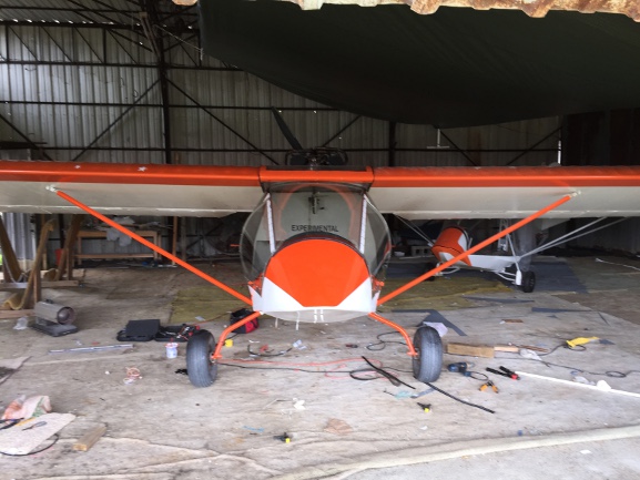

What's wrong with it. It looks factory. You did a nice job. I wouldn't
change a thing.

PostPosted: Tue Mar 17, 2015 9:19 am    Post subject: Re: MK III - New Nose - Nice Job Reply with quote
Looks Great! any picts of the building process?

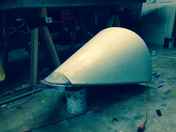

Here are a few pictures and a description of the process.
1. I drew a template of the existing instrument panel shape and transferred that to the fiberglass sheet and cut it out. I then attached some tabs for the top and side attachement
2. I clamped the template to the appropriate place on the frame.
3. I fixed two pieces of PVC tubing about 1 inch in diameter along the bottom of the frame representing the bottom edges of where the nose needed to go. Make sure these are at the angle you want the bottom of your nose to be.
4. I bent a sheet of fiberglass over the panel template and riveted it to the pvc and the tabs on the panel.
5. I did not use a template for the front, just made sure it was an even curve. The front will be open at this point.
6. I did the same thing to the bottom sheet.
7. I sanded the edges so they merged with the PVC pretty well.
8. Coated the PVC with mold release wax. The edges of the fiber glass sheet need to be left smooth so that a layer of fiberglass tape will stick but not stick too well. Don't fasten down the edges of this tape. I had no trouble with this but this outside layer will need to be peeled off.
9. Once you have shape you want, lay up one layer of fiber glass over the PVC lapping over the panels an inch or so. (This layer will be removed)
10. Once that setups up drill out the rivets and remove the pvc tubing. Put some additional release wax on the inside of fiberglass tape layup.
11. Layup fiberglass inside the cone using the thin outside layer to give you a smooth radius.
12. Once that has hardened, peel off the outside layer. (You should be able to remove the cone from the frame at this point.
13. Fill and sand the joints smooth.
14. Take a small block of foam (you can build this up from a few thin pieces) and attach it to the open front. I carved the back of the block to fit the hole and left a gap in a few places to run strips of fiberglass from the inside of the nose to the outside of the foam plug.
15. Sand the foam to the shape you want and then glass the outside overlapping the pieces already there. Edges should done by creating a 'lip' along the bottom (see photo) that the top can make a good joint with. Then fill and round out with lightweight filler.
16. Fair it and paint it.

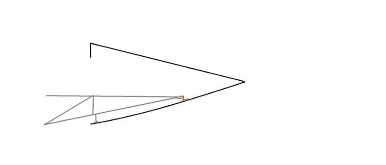

17. I removed the front nose frame attachment and used tabs welded to the front of the cage that attached to a Z shaped fiberglass lip within the cone. Pretty easy to reach from inside and invisible from the exterior. This is not necessary however and you can use the old attach points.
Hope that makes some sense and I'm remembering all the steps. It was actually easier than it sounds I think. Note that to use fiberglass on foam you will need to use epoxy as the polyester stuff will melt it.
