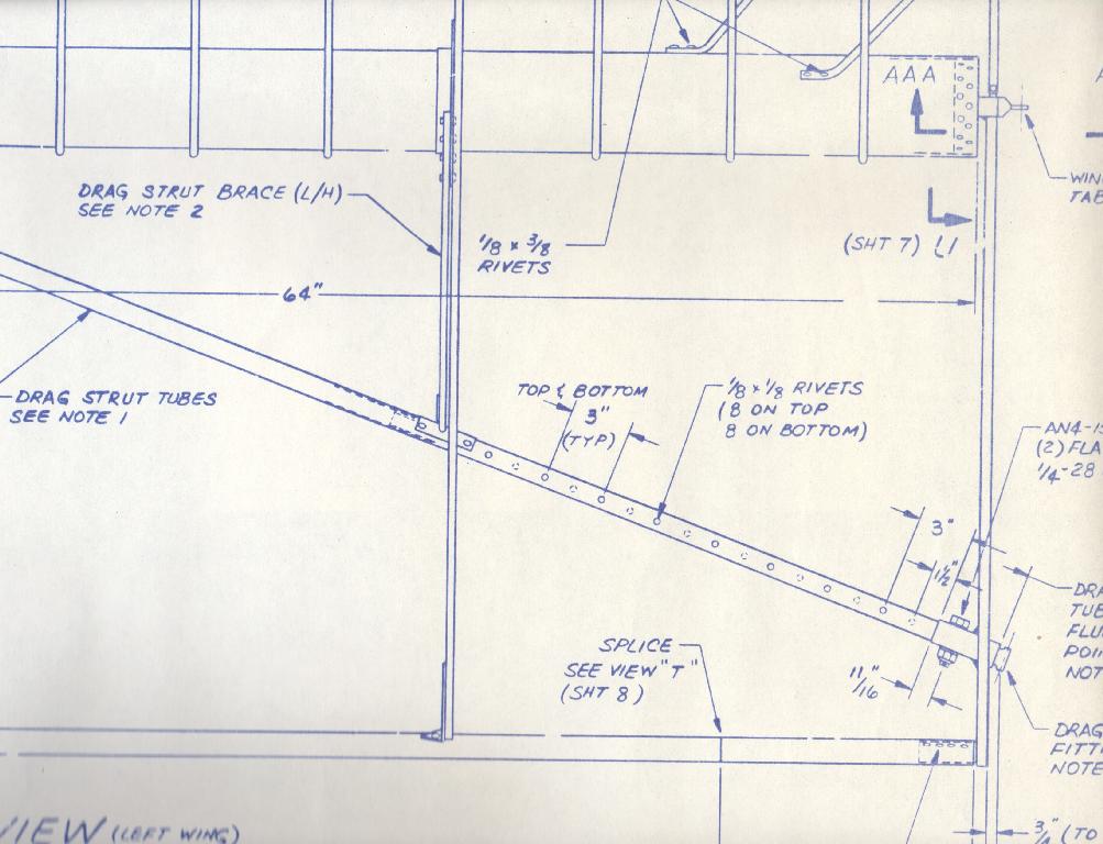

PostPosted: Sun Mar 22, 2015 6:52 pm    Post subject: Re: Riveting question? Reply with quote
maybe this helps,
I have a complete set of plans and the book for Firestar
 Filesize:  152.16 KB
 Viewed:  9957 Time(s)

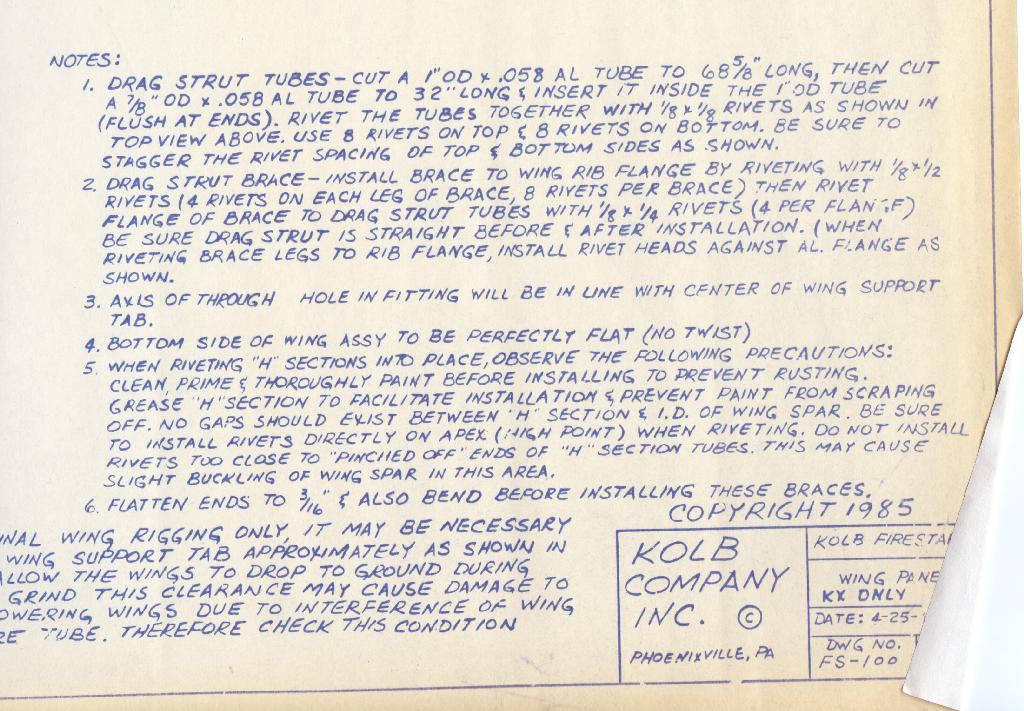

PostPosted: Sun Mar 22, 2015 6:57 pm    Post subject: Re: Riveting question? Reply with quote
here is another pic
 Filesize:  89.05 KB
 Viewed:  9953 Time(s)

Thanks...but guess I did not make it clear...it is the drag strut
fitting plates, which attach the strut to the Spar tube and into the H
section..at the lift strut attach area... There are two gussets; the
thick one on the bottom of the wing and the curved thin one on the
side.. Herb

PostPosted: Mon Mar 23, 2015 4:16 am    Post subject: Riveting question? Reply with quote
hurb
my plans call for 1/8 1/8 steel rivets on the side gusset and 1/8 1/4 steel rivets on the bottom, these should be steel and not stainless

byoungplumbing(at)gmail.c
PostPosted: Mon Mar 23, 2015 5:55 am    Post subject: Riveting question? Reply with quote
My mk 3 plans show.   1/8 x1/4 rivets on 1/2 in spacing.   Where drag strut gusset attaches to Wing spar into H section     my H section is uninstall chrome Molly steel.  If you have thick wall aluminium H section you will probably need longer.
