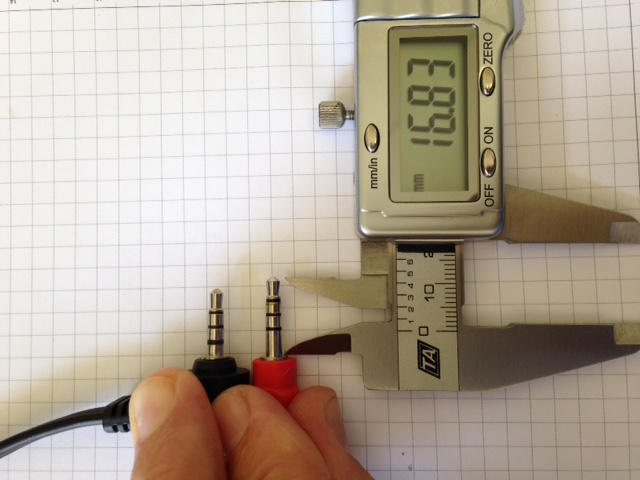

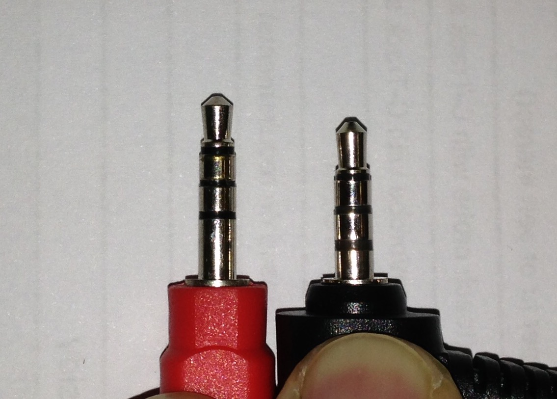

Hi Richard
Having been down a similar path recently (however looking for the plug and not the socket) I came across two different standards of 3.5mm TRRS plugs. If you do find something that looks like what you need online, make sure the dimensions are suitable! The longer version (red) is manufactured by Cliff in the UK, and they do sell to the public. This seems to be used on many set-top-box media players. The shorter version (black) is more commonly used in handheld devices, and relatively easy to come by. They are not mechanically or electrically compatible, with a different order of the connectors. Even Ground is Sleeve on one and Second Ring on the other!
See attached pictures for comparison.
Etienne
[img]cid:ii_14c27b0346e6b4e3[/img][img]cid:ii_14c27b0352cdde19[/img]

PostPosted: Tue Mar 17, 2015 6:59 am    Post subject: 3.5 mm 4 pole socket Reply with quote
The difference in contact assignments on this plug type is vast, as it has been used for many purposes, from audio with microphone, to audio with battery charging, to serial data interface. It's not even consistent among cell phone models with respect to ground and microphone assignment.
If you're sourcing a patch cable with the same plug at both ends, it makes no difference, but plug adapter cables with something other than TRRS on one end require care to ensure compatibility.
See http://bit.ly/1FvOcuj for a long list of TRRS plug applications.
Eric
