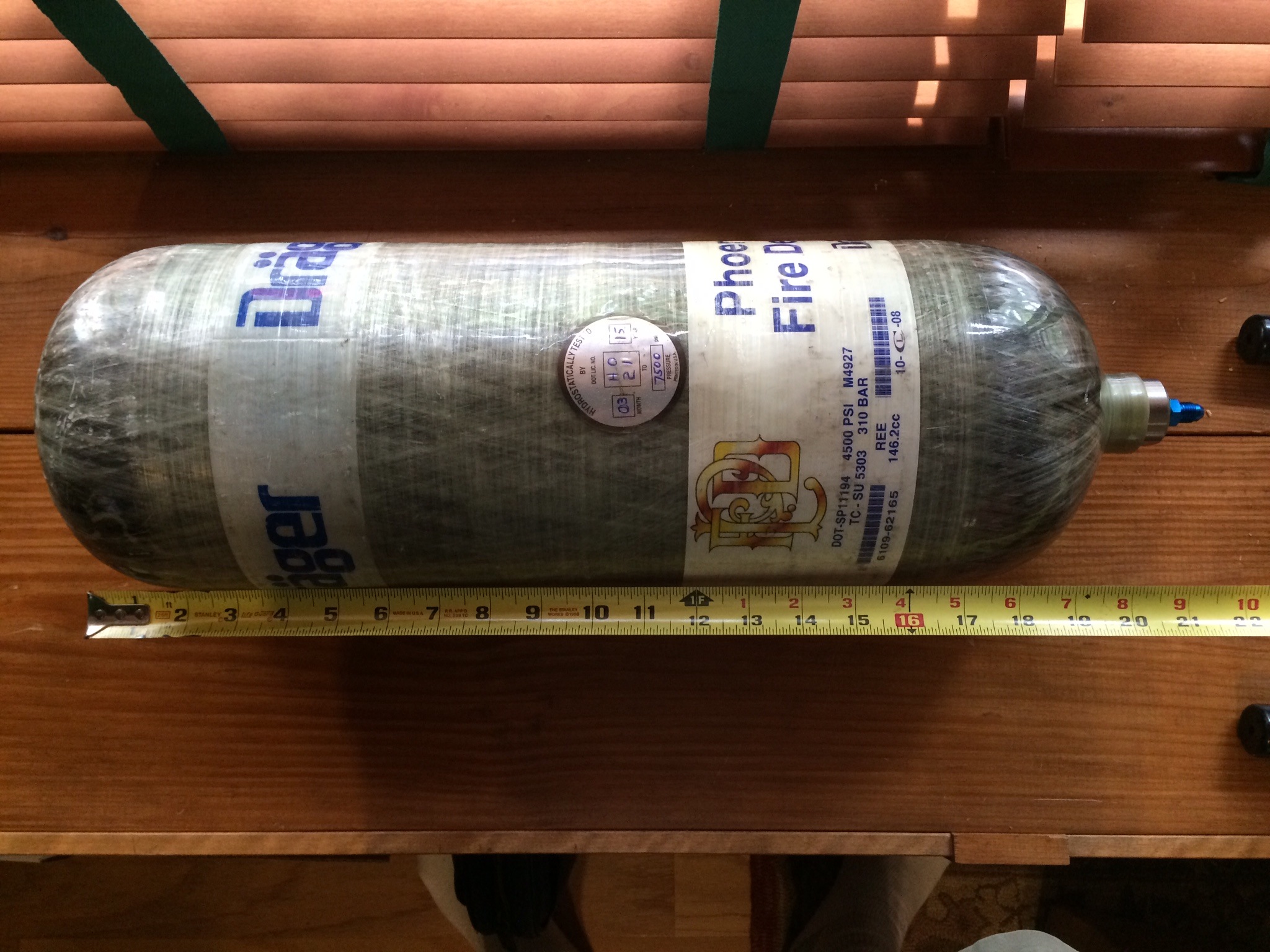

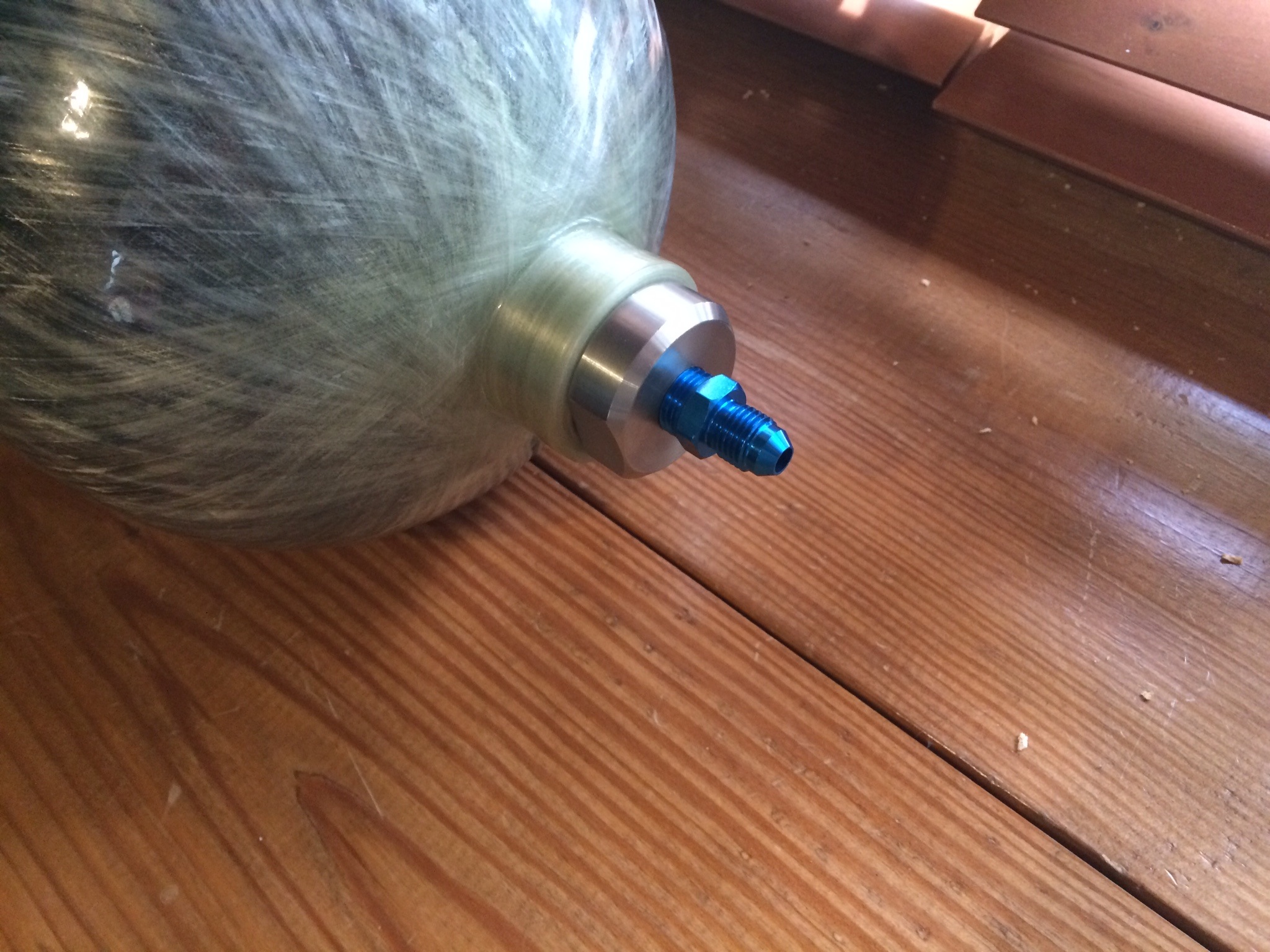

Here are pics of the tank I fashioned for my plane.
Specs:
Drager 4500 PSI 60 min Carbon Fiber Wrapped Aluminum Tank.
Weight 10 lbs
Length 21"
Diameter 7"
Hydro Tested to 7500 PSI.
Fittings:
Stainless Steel SCBA to NPT Adapter
NPT to AN #4 Male Adapter.
This should fit in the same bracket where the stock tanks lives. All thats left is to create an aluminum tube pigtail with an AN B-Nut on one end and the Chinese Nut on the other.

Would a Drain port be needed here as in the original tank for draining moisture/water?

Air dryer filter as on airlines for paint gun? Cheap and easy before bottle.

Good question. Unfortunately High Pressure tanks have to be seamless so a drain port is not a possibility. This is why it's important to keep your air dryer serviced. But since it's aluminum rust isn't an issue. Would have to make it part of the annual service routine to remove and dump.

I didn't machine it, you can buy the adapter on Ebay for $35.

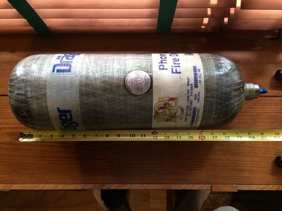

wlannon(at)shaw.ca
PostPosted: Sat Mar 14, 2015 7:23 pm    Post subject: Main Air Tank Reply with quote
Ernie;
“Since it’s aluminum rust isn’t an issue�. That may be the case but only if it is pure aluminum which is protected from corrosion by it’s own oxide layer. If it is an alloy that protection is seriously degraded depending on the alloy composition and strength.
Pure aluminum has a strength something like cheddar cheese. However if the entire strength of the tank is derived from the carbon fibre wrapping then pure aluminum would be suitable.
Something to consider.

From: Ernest Martinez (erniel29(at)gmail.com)
Sent: Friday, March 13, 2015 4:36 AM
To: yak-list (yak-list(at)matronics.com)
Subject: Re: Main Air Tank
Sam,
Ernie

Viperdoc
Ernie
Joined: 11 Jan 2006
Posts: 513
PostPosted: Sun Mar 15, 2015 6:18 am    Post subject: Main Air Tank Reply with quote
Yep you're correct, if it's not the right alloy, it could be a problem. Fortunately these things are strictly regulated. The aluminum tanks by themselves are rated for 2260 PSI, the Carbon Fiber brought them up to 4500 PSI. Again, at the pressures I'm going to run it at, its not an issue at all. Also remember aluminum scuba tanks are made of the same stuff and live in salt water all their lives. At the end of the day it's all about diligent maintenance.
The reason I'm doing this because I'm terrified of my current 40 yr old steel welded tank, that I have no reliable history on, and can't get hydrotested locally. Yes I know there is some place I can ship it to, but I have several issues with that. I'd rather be able to do it locally and have it back the next day. And I like the fact that it's tested to known parameters (7500 PSI), and a guy is willing to put his name on it and certify it.
But since it doesn't fit where the original tank goes I've given my self a good reason to mount it where it will be VERY easy to remove Smile The stock tanks lives under my smoke system and Battery box, shelf and I'm going to have to remove everything to get the bottle out.
Ernie
