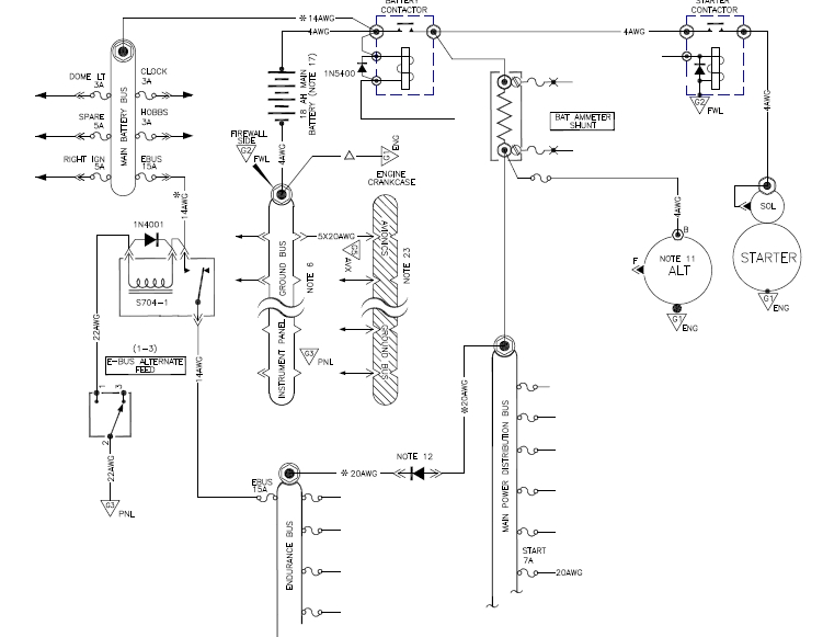

Now, if you truly want a -0+ battery ammeter,
you'll need to arrange for the shunt NOT to carry
starter current so that the ammeter sees only
flow to/from the battery. This still doesn't measure
loads in the endurance mode but it will let you
interpret recharge behavior after a start.
Like so . . .
