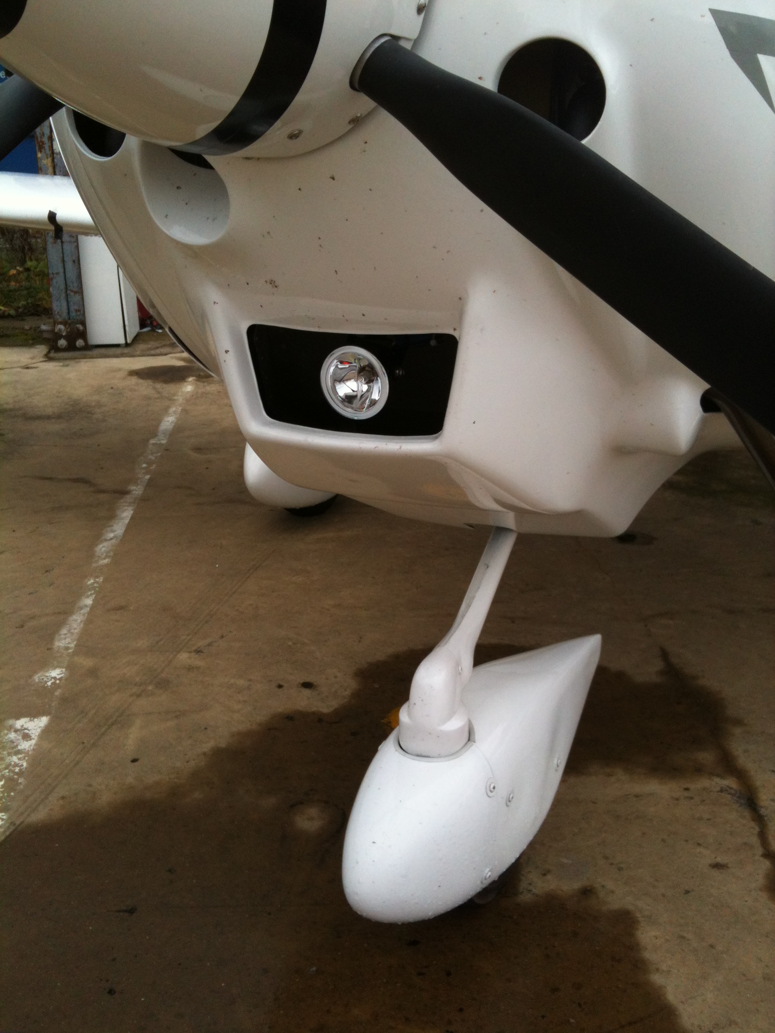

I did just this on G-TAGR and got LAA MOD approval 13072 in 2011 - using a 'Parts for Aircraft' sourced 55W H3 halogen light kit including bracket mounted to the air intake aluminium ducting as image uploaded. I later swapped the bulb to an LED as the current drain is dramatically reduced and equally as bright. If you wanted to do the same an repeat MOD application would be needed - citing 13072 to save you work. Went to quite a lot of trouble to make sure it would not go into resonance as a result of excitation vibration from e.g. prop or engine out of balance forces.
regards,
Clive
